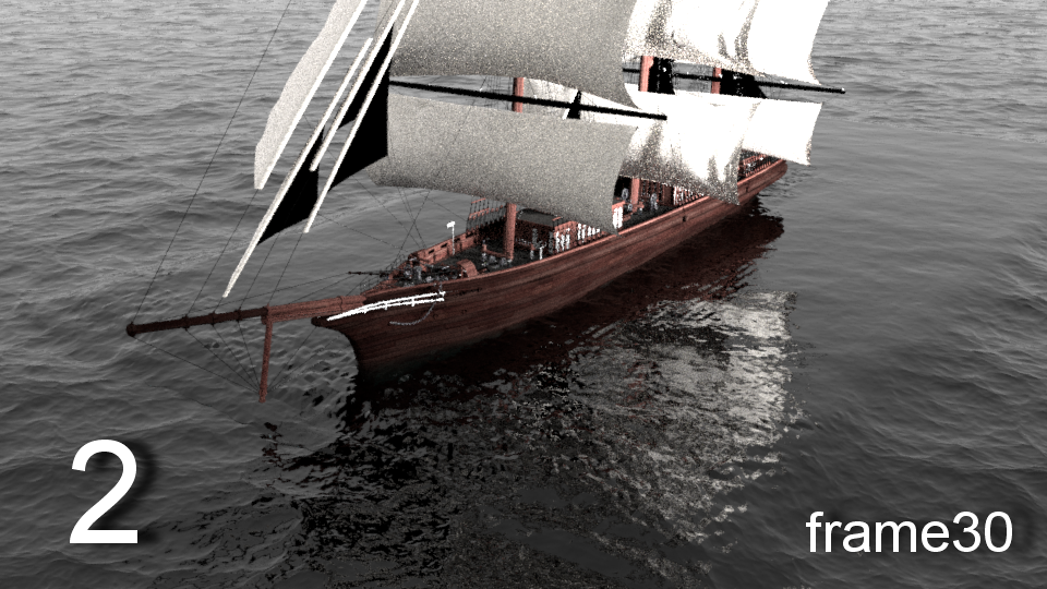

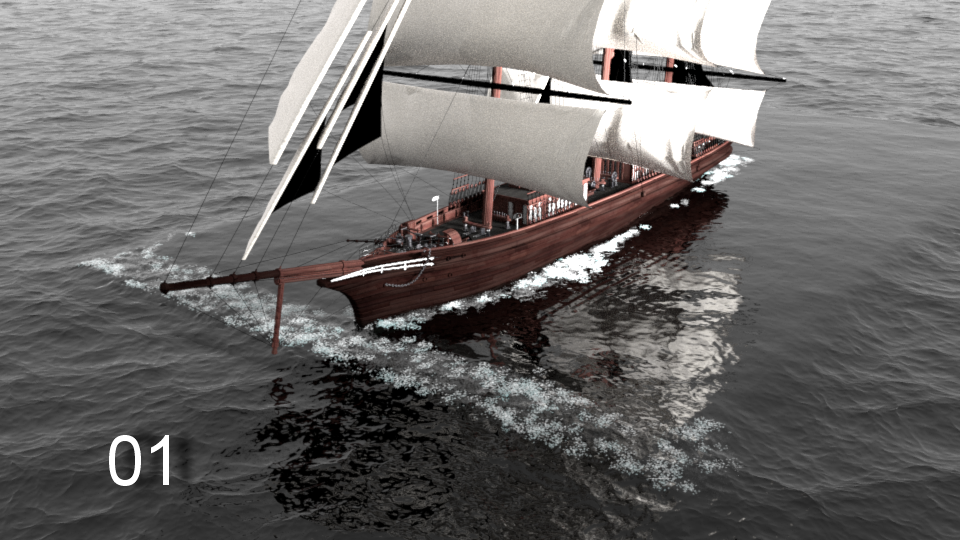

    1. Why the foam and splash start Appear from edge of Simulation like photo 1
    2. Why liquid in the container bounces up and down Between frames , it is good at first but after 20 frame its go up like photo 2 and 3

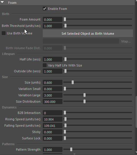

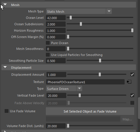

    Ok, first make sure you've got latest nightly version and see If the problems are still there. Also, you can upload a screenshot of your phoenix settings because it's hard to say what could cause this things.

            Shouldn't the initial fill up and ocean level be the same? Might not affect simulation thou.
