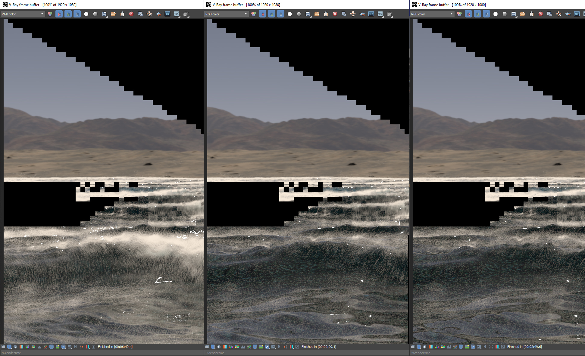

                  And it looks to me like you are rendering with a Particle Shader in Point mode, you have enabled motion blur and you have a Motion Blur Mult. on the particle shader set way too high, or your rendering motion blur duration is too high. Could that be it?
                    So do you mean that more motion blur would help or less motion blur? I thought if I use less MB then it will look worse, even MORE like throwing sand.
                      I suggest you start by overhauling the simulation settings entirely. Compare all your simulation settings, including the scene and simulator scale, as well as the wave force settings to the Beach Waves example: https://docs.chaosgroup.com/display/...Example+Scenes
                        Blur increase on left. Middle is original. Right is zero motion blur.

                            Hmm, are the splash and foam particles selected twice in the particle shaders, or are you rendering two different sets of splashes and foam? Also, which Phoenix version are you using? There was an issue with Force On of the motion blur in older versions when the renderer motion blur was disabled. Do you have motion blur in your camera, or is it also off? And finally, would it be possible to also share your wave force settings? The overall result of the simulation looks very different from the beach waves example and there must be something you are missing. For example I don't see foam patterns forming at all and the particles are fairly uniformly distributed...
