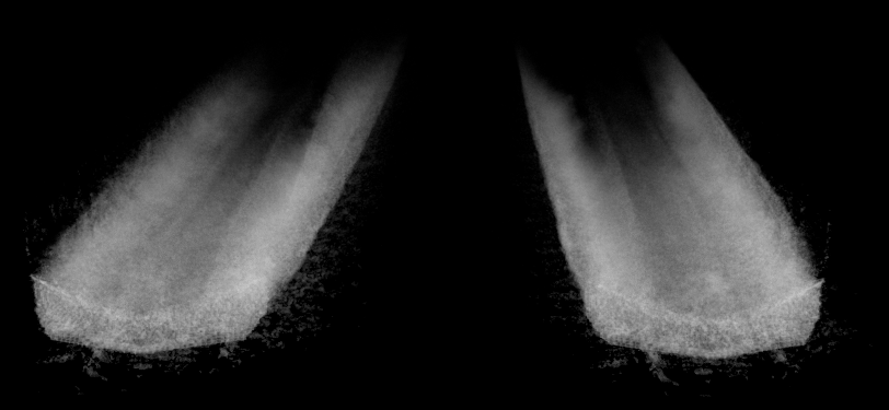

                Thanks for clarifying Georgi. Yes, indeed I haven't turned on the V-Ray settings' Motion Blur. We cached two versions: a low resolution version with about 5.000.000 total cells (just to be used for previz) and another one with higher resolution totalling 75.000.000 cells for final renders. The latter is the one I gave to you.
                The guy here in charge of rendering is dealing with the Final rendering. I forgot to tell him to get the HiRes cache to do the motion blur. Now it's working. So conclusion is: With low res cache, the motion blur will be indifferent no matter if we tweak in the simulator or Vray Settings.

                2- here, I do the simulations and pass the cache result on to another guy in charge of Rendering. He will import the cache I produced in Phoenix into VRay Volume Grid for final rendering and easy manipulation. That's the time he will apply motion blur. We realised that PhoenixFDFire produces a different result in comparison with VRay Volume Grid, including obviously the motion blur look. Is this correct ? I know this is already beyond the topic in this forum, but just to show you the difference between them, I have attached an image showing how they look different (Motion blur is set to 0).

                    Ah, please check this page - it contains essentials: https://docs.chaosgroup.com/pages/vi...onandRendering
                    In short - render settings are not stored into cache files; the caches contain only physical simulation data. You can transfer render settings by saving a preset from the Rendering rollout and then loading it into the Volume Grid.
                    Hope this helps!
                      Oh boy. That worked ! Thank you guys ! VRayGrid and Phoenix are the same now.

                      No Motion Blur (value = 0)
                        Motion Blur = 1 below
