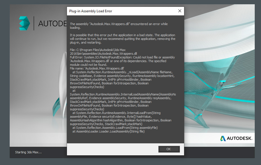

    I'm getting a 'Plug-in Assembly Load Error' when starting up 3ds Max 2016 once Phoenix FD is installed. I've attached a screenshot of the error message.

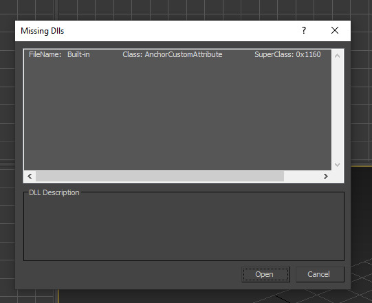

    A further 'Missing DLLs' message appears upon trying to open any files once 3ds Max has started (screenshot also attached)

    Huh, strange, can you check the en-US directory of your 3ds Max install - usually in C:\Program Files\Autodesk\3ds Max 2016 - and paste here what is in the plugin.ini file?

            The problem seems to happen when the installations of V-Ray and Phoenix FD are not made in the proper order.
            Could you try uninstalling V-Ray and Phoenix FD. Then install first the latest V-Ray 3 Stable - https://nightlies.chaosgroup.com/mai...e_3.7/20191004 and then today's Phoenix FD 4 Nightly - https://nightlies.chaosgroup.com/mai...ghtly/20200513.

              That's great - it seems to have fixed it. Thank you!
