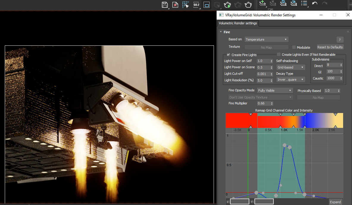

Seems like glossy reflection fireflies are still an issue after all these years? I'm getting some crazy ones testing a scene right now with some pretty glossy metal. Unfortunately in VRay Next some renders settings that helped this issue like sub pixel clamping seem to have been removed. I turned down Max Ray Intensity to 1 even, still got them. It'd be nice to keep the reflections if the fire in the metal if possible. Any tips? Using Max 2021.3, VRay 5 hotvix 2, and Phoenix 4.3.01

Increase Min Sampling. Try a softer Image Filter (like Soften at 2px-4.5px).
Try the denoiser (especially the post process one for animations).

Does it help if you reduce the Max Ray Intensity in the V-Ray settings?
Is it possible to send us the scene along with a Phoenix cache file so we can check what is going on?
You can either attach it here as a zip, add a g-drive link or something similar or if the scene is confidential you can send it to the chaos support mail with a link to this thread.

Yeah, Max Ray Intensity still no effect Ok lets see if this link works...it's just a fun side project so I'm fine sharing it. I'm sure it's something dumb I did... https://1drv.ms/u/s!AvuE3OEoHv5Rgd4g...wuSGw?e=jQi9NC
Originally posted by Joelaff View PostPerhaps try the update script above (I changed the original posting). Not sure that enables the subpixel clamping or not.
Originally posted by japetus View Post
Well, now that actually did work! However...my fire is kind of dim and transparent now (some what obviously)...i imagine if i could set a value too that would help. But yeah not exactly an ideal workaround there...
