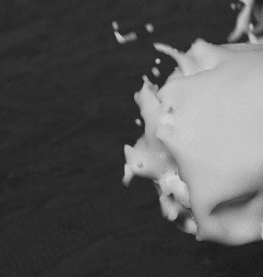

    I'm seeing this with every sim I try to render with vray GPU when using RTX. As per screenshots, certain frames don't appear to be creating the mesh correctly at render time and this can result in weird dark artifacts that flicker during animations. This could have something to do with motion blur as I think the problem isn't there with motion blur disabled. Issue doesn't exist with CUDA. I logged this as a support request a few days ago as an issue with Vray GPU (request no 349-680-8313) but haven't had a reply or a download of the scene files that I uploaded. I'm now wondering if its something to do with Phoenix as it only seems to be happening on Phoenix sims. Also the phoenix team seems to respond a lot quicker to forum posts than Vray support requests

                Thanks a lot for the reports, finally we managed to reproduce it. Looks like it happens only on Nvidia 3xxx cards when you're rendering with Motion Blur in RTX mode. As a workaround for now you can render in CUDA mode.

                  Yeah that sounds about right, I've only got a 30 series system to test on but I noticed it wasn't there with motion blur disabled. I think I mentioned my drivers in the support request but using the recommended 471.11. This bug has been around for a bit as I spotted it back in March, just didn't have time to report it then. Let me know once there's a fix. Thanks!

                              Yeah I'm seeing this issue in more scenes now, some with very basic materials, and without even any phoenix sims in the scene. There's some serious bug with RTX in the current code. It seems to happen on random frames, so this basically means I can't risk rendering with RTX enabled in animated sequences at the moment.
