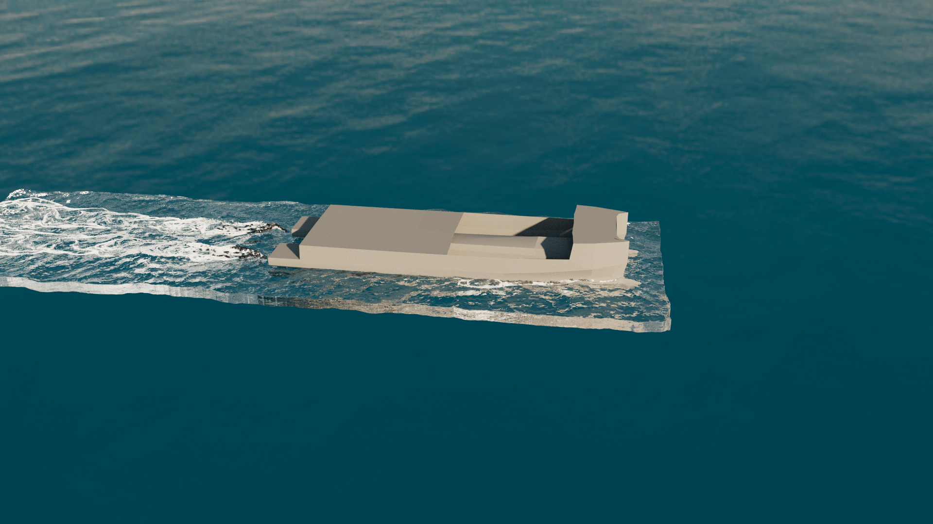

    I'm running a liquid/ocean simulation of a catamaran sailing through the water at 6 knots. Rendering in Vray 6 Maya and the particles are in point mode.
    Parts of it appear black and I have no idea what the issue could be.

    Hey, could it be that these are the particles below the water surface? Could you do a test - please switch to Mesh mode instead of Ocean Mesh and see if anything in the particle render changes. If it does, then you might need to add some geometry below the water to act as the bottom - this way V-Ray would know how thick the Fog color of the vraymtl should be. Btw, are you rendering with V-Ray CPU?
    Thank you!
      Hey,
      I tried switching to mesh mode and the particles still appeared black.Yes, I'm rendering with Vray CPU. here's the full screenshot of the mesh mode render
        Hey,
        Can you send over the scene so that we can take a look what is going on? You can either attach it here as a zip file or send it through the form (there is a link Submit a request in the top right corner).
        Does it help if you reduce the Point size in the Particle shader or if you decrease the Shadow Strength?

          Also, does it help if you enable the Render as Geometry option from the Particle Shader rollout?

            Slavina I tried the Render as Geometry, but that made no noticable difference. here's the zipfile of the scene file. The hdri I used is part of a free pack. if you want to use it, it can be found here https://cgi.tutsplus.com/articles/fr...hdris--cg-5684

                Everything seems fine here. I used the scene that you sent, simulated and rendered it. Tried with Mesh and Ocean Mesh Render Modes and the artifacts are not visible. I rendered a couple of frames around the 360th frame - from your screenshots it looks like that the artifacts are appearing around those frames. I'm using Phoenix 5.01 Nightly from 12.12.22 and V-Ray 6.
