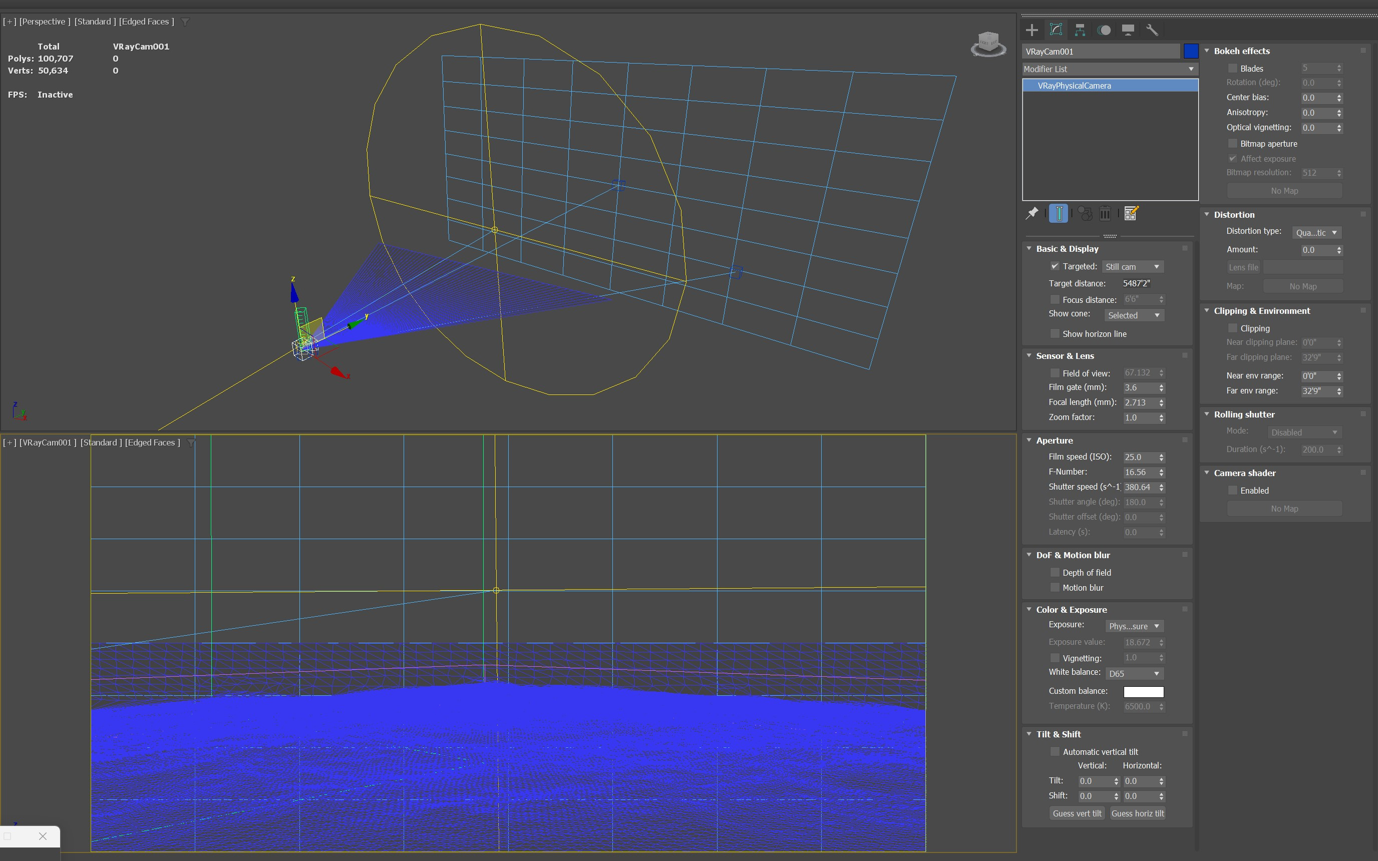

    Hi, newbie here. I've been trying to figure out what is causing the strange lighting anomaly as shown in my rendering that occurs periodically (see attached). Clearly it is caused by the Infinite Ocean. I'm using Phoenix 5 on 3DS Max 2023 and V-Ray 5 with 32.0 GB of RAM.
    Thanks in advance,
    Kevin
