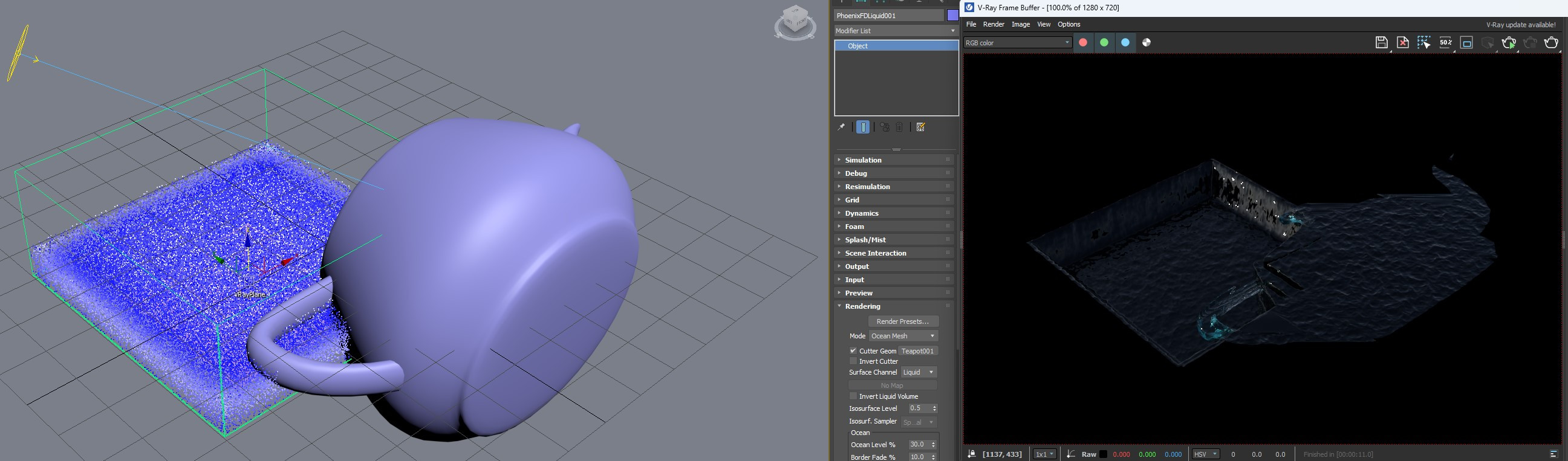

              Aha, I got something more than I thought with a quick hack - the idea is that you would need to use Cutter AND Clipper, but the memory usage should be much much lower:
Name:	ocena cutter.jpg
              This will be in tomorrow's nightlies.
