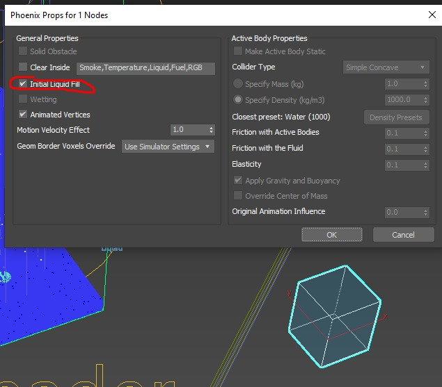

          I suggest you change you setup a little. Disable the initial fill up from your Grid. Instead use the inner walls of the fountain to create a fill up geometry. Right click on it and choose phoenix properties and then enable the "initial liquid fill" check box.

          This way only the selected geometry will be filled up with liquid when you start the simulation.

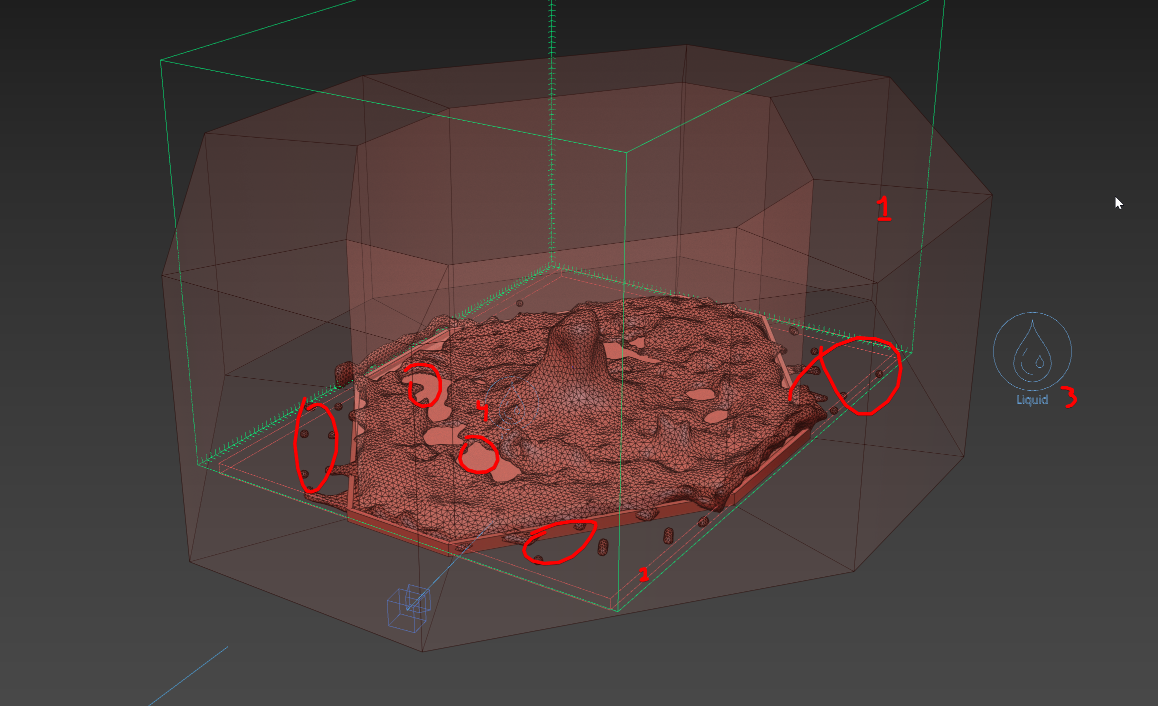

                      Hi Vladimir. Thanks, I understand that. I've tried setup you proposed and it is still behaving very weird :
                      ​1 is the negative volume - you can see the particles perfectly travelling in it.
                      2. in the bottom - is the initial fill volume - it is filled as expected
                      3 is the liquid source for the negative volume
                      4 you can see again those spots without particles and particle amount being decreased constantly.
