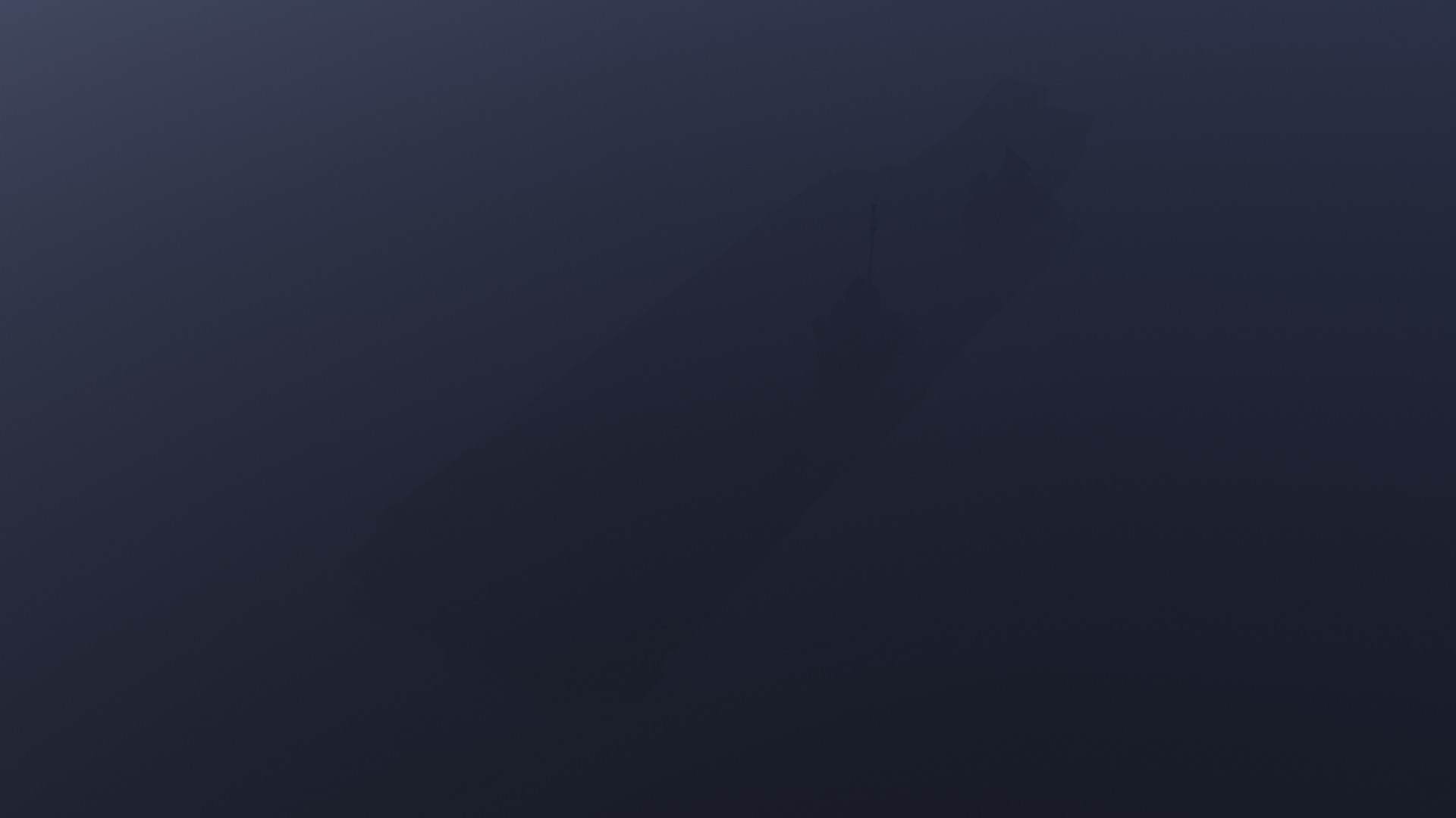

                I thought I was getting somewhere, but I haven't found the source of this problem. 3 out of 4 rendernodes have stuck again. My animation is nowhere near finished. I took a screenshot of the framebuffer, and the renderqueue.
                If anyone has ideas about what to try I would be very grateful!
                  I'm trying to switch to progressive sampling. It still looks like it gets stuck. 2 machines are stuck rendering a pass (22 and 25). I have set it to quite low settings, Max subdivs 24, rendertime to max 25 and Noise Treshold 0,015.
                  The image looks almost good enough with a bit of denoiser. How can I force it to move on instead of getting stuck?
