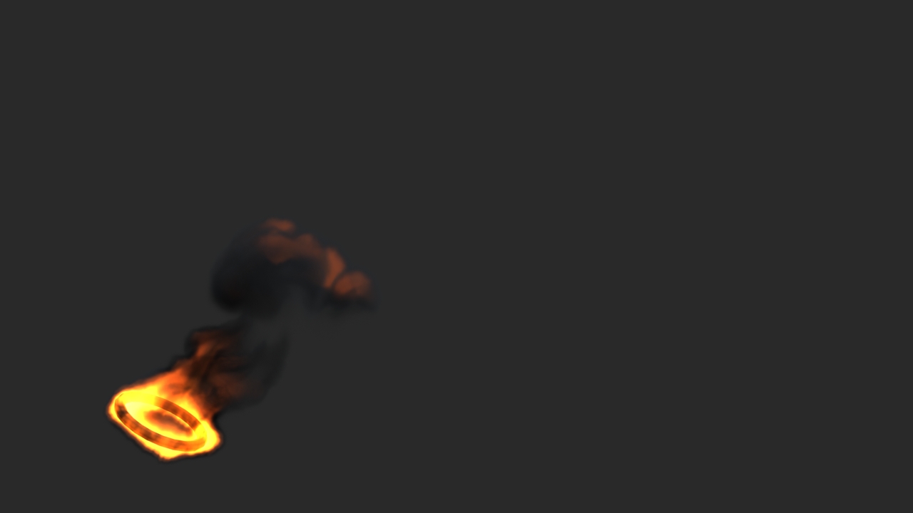

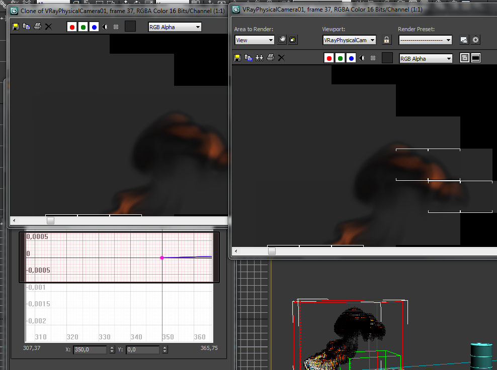

      ...and here is some images showing the problem.
      I hope it's still visible in these jpeg's.

        can't see the problem, only the transparency is not equal, perhaps the fog distance is different from the cell size.

          Okay, now I did get rid of it. Went playing with transparency settings again, resetting it etc. and now it works.
          Anyway, it's weird how it worked earlier. I mean, how it was visible in envfog only.
          "can't see the problem, only the transparency is not equal, perhaps the fog distance is different from the cell size."
          Yeah, the effect is really light. I can see it only when I cycle those attachements and imagine the place for the grid.
          But in vfb, it is more visible and can be seen when checking pixel values too.
          Hmm, I could send you the non working scene anyway. It's ultra simple and light.

                      heh, i think i got it. when you said "grid" i sought to see the cells of the grid, that are almost always visible, but not in your case not the cells, the box is the broblem isn't?
