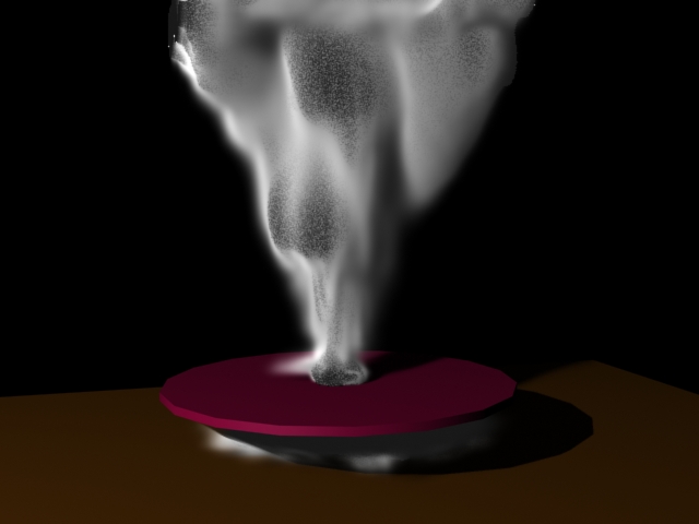

    I'd like to simulate a blobby smoke of a chimney for ex.
    here is my poor result....
    At first I'd like to get rid of the noise,
    and more and more....
    any help please.
    best regards
    nano

    see the neighboring thread dedicated to the heavy smoke, you can use the scene and to change the buoyancy to positive value. decrease the resolution first, for faster adjustment.

      I already tried the phoenix_smoke scene ,
      well i'm too newbie and understand nothing....
      do you know how I could get rid of the noise (see the attached file in my 1st post.)
        looks like the color of the smoke changes suddenly to black and this causes the noise - the last step of the different rays has too big importance for the final color. can't say more without the scene
