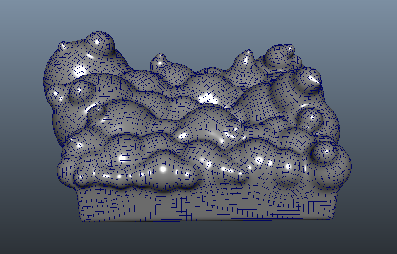

    Hello,
    I am trying to fill an object with the brush mode, but I just cannot get it to work.
    http://help.chaosgroup.com/phoenix21/tips.htm#initfill
    Perhaps I don't get the first point "Create a geometry covering the volume that should be filled with the liquid."
    So are there two geometry's in the scene - one emitting the particles, the other excluding them - or just one doing the exclusion.
    Perhaps someone could take a look at my maya scene.
    Thnx a lot in advance
    Martin
    fill_brush_mode.mb.zip
    You have to add the geometry used as a brush as a source-object and just hide it:
Name:	2014-04-23 11_40_11-Autodesk Maya 2013 x64_ D__Support_721_Phoenix_fill_brush_mode.mb_fill_brush.png
    Scene:fill_brush_mode.zip
      hello,
      thanks a lot, it worked like a charm. I really enjoyed to start the emission from a cloud-like geometry and not from a cube.
      The whole anim is about a monster "diving" up from the clouds. I will start a thread in the main phoenix section showing our progress.
      Thnx aggain
      Martin
        just a tip: set the vorticity to zero or some low value to prevent the changes of the parts of the cloud still not affected by the object.
