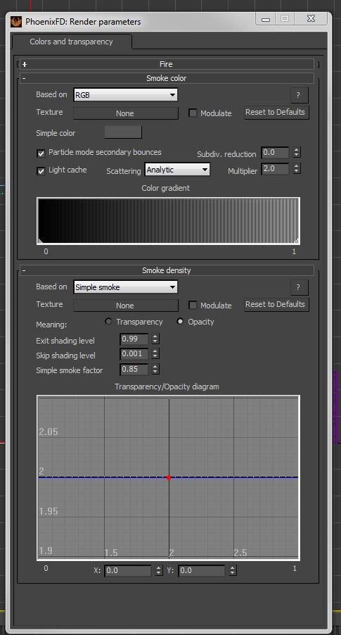

                Here is the smoke settings. I have two lights, a low lit dome and a very bright sphere light. Both lights have default settings.
                  I'm going to have to ask you for a scene file again - using these settings with the scene you sent previously, the render seems fine to me and unlike your video doesn't have these dark separated areas. In general, in order to squeeze more detail from a smoke render, you may try a custom transparency curve with sharp spikes - this will make it look either like cigarette smoke or will generally add string-like structures.
