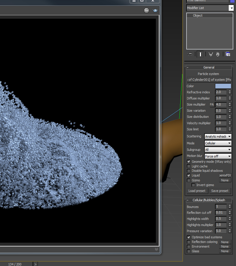

                  Hi, thanks
                  I've attached the settings anyway, but I'll look at the light subdivisions.

                    you can try also the option "optimize bad systems", by default it is enabled because if you have too many bubbles in small area, this may produce very long render times, but the most foam simulations are ok. this option can cause flickering because it affects the foam size even if the bubbles are at acceptable distance.

                      one more possible flickering cause - the liquid is invisible, but the option "liquid" is enabled and if you have particles at the liquid surface, they may be rendered differently in every frame, because small change in the position can put the particle from inside to outside state.
