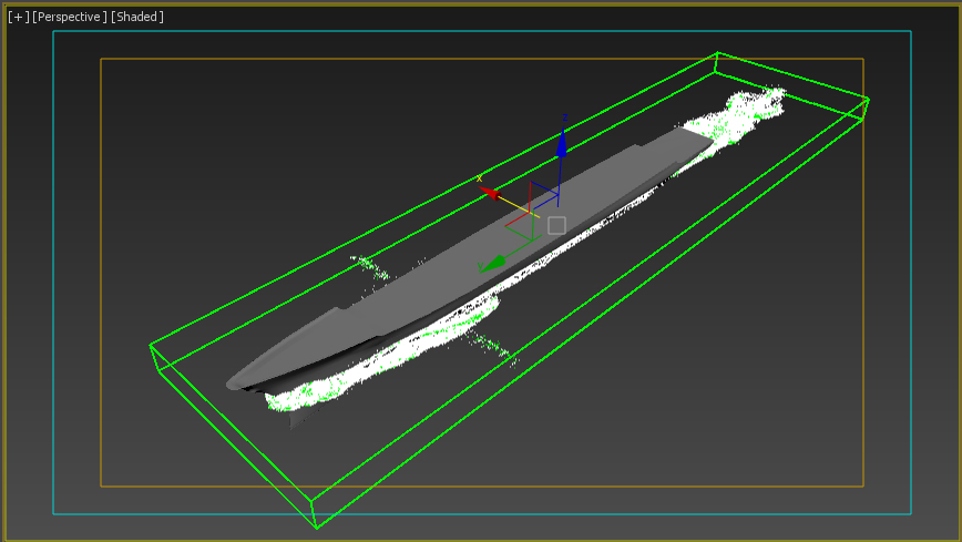

    Hello everyone! I'm using the tutorial provided that demonstrates the ship wake and I've replicated everything perfectly, but I keep running into a strange issue. Around frame 95 a line of splashes and foam appears and continues on for the rest of the simulation. It becomes less pronounced with less refined grid until I lower the amount of cells enough for it to disappear, but then there's not much definition in the foam and water.

      I've got the same problem, except I also have random particlesspawns all over the place. Last sim went fine, but now the vessel is animated back and forth in a rolling motion. Thats the only difference.
      STF was low on the last sim, but the sim crashed during simulation with the last setting which was 2, so I tried to up the steps to 4, and now it goes through the sim fine, but these rogue spawns shows up.

          Here is the scene.
            well i found it, the option "from free fly" in the splash birth is to blame, just set it to zero. this option is intended for waterfalls , but the idea was that it can't harm the other sims (apparently it can)
              Aha, thanks. I actually did play a bit with that option, but I never put it completely to zero, as I thought it had something to do with the birth parameter for the splashes.
