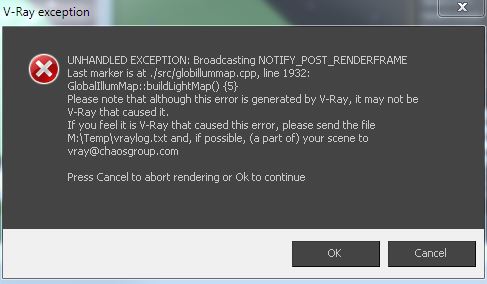

                I've got another problem now. Since adding a PHXFoam helper to shade the foam I'm getting the attached error.

                  another user reported for problems with irradiance map, is it involved here?

                    I'm using BF+LC & Vraysun system.

                      can you attach the scene with a single cache that porduces the bug? you can send them to the support, if the cache is too big.
