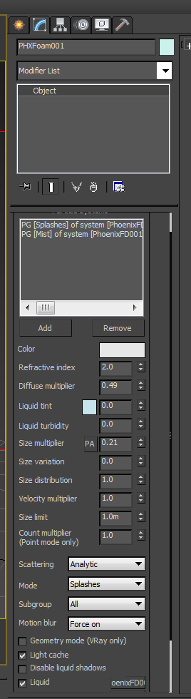

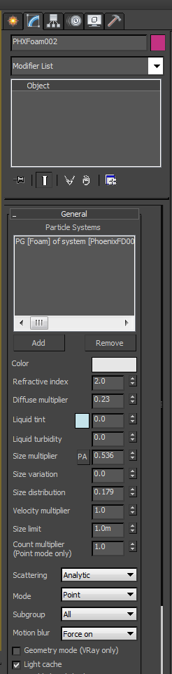

I have 2 Foam shaders one for Splashes Mist set to Splashes and Force on Motion blur. And the other is Foam set to Point and Force on Motion blur.

I have tried turning Foam shader force off motion blur and even simmed whole sequence no Velocity no motion blur and still same result. ?
![Click image for larger version
Thanks
