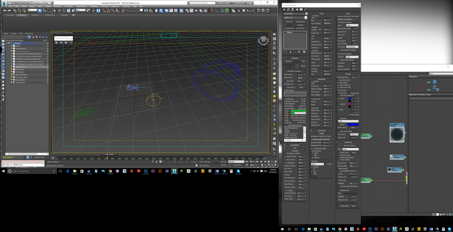

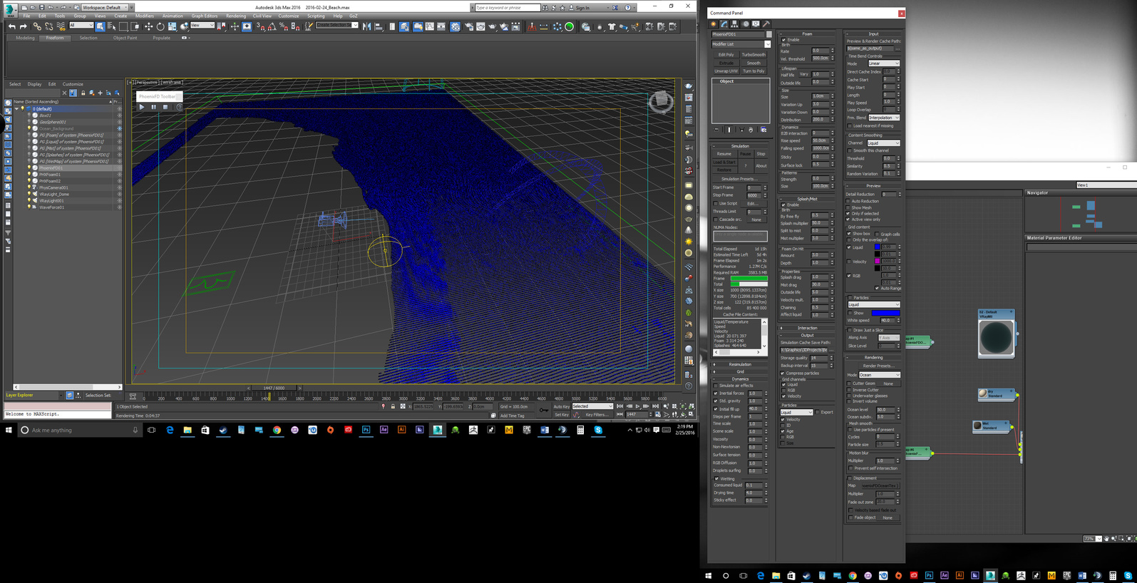

    Enabling the "Show Mesh" in the preview displays nothing. That explains why I am seeing nothing in the rendering. But now the mystery is why am I seeing nothing? I'ts a complete blank. In the two attached images you'll see the ONLY change is turning on "Show Mesh" button. Any reason the mesh is disappearing?

    • #17
      Huh... well for this we'd love to have the scene and debug what's happening. In case there's sensitive data in it or it's too big, you may also send it via support@chaosgroup.com.
      Cheers!
      • #18
        I'll zip it up and send it to support. Thanks!
        • #19
          the usual reason is wrong value of the surface level, the liquid simulator does not have UI to control this parameter, but it is existing. try to type in the listener when the simulator is selected $.surflevel, this must show the value
          ______________________________________________
          VRScans developer
          • #20
            Hey Teriander,
            Found the issue - the scene went wrong during conversion to a liquid simulator, I will add a fail-safe for Monday's nightly, but you can workaround it yourself by selecting the simulator and typing in:
            $.sarg=1
            ... and this will show the ocean again.
            Thanks for reporting this issue! Cheers!
