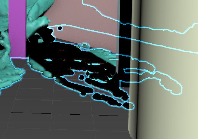

    I think in previous versions there was a way to specify the software how much to actually use and convert to a mesh.... I see a lot of particles in this frame that are quite close and yet are not part of the mesh when I render.
    the jpg compression almost hides the particles, but i think they are not liquid particles, perhaps foam or something like this?

      there are only liquids, not foam or splashes, may be on this screenshot you can see it better.Click image for larger version
      I thought there was before a setting on the mesh conversion that changed how much or how close or a threshold for converting the particles to a mesh.... or I'm wrong? in this case you can (i hope) see a few hundred particles that are being ignored.
        they are displayed as red dots....
          These look like the wetting particles, they are red by default in the preview. You can try turning off the preview of everything but the liquid particles. Only the 'Liquid' particle group is meshed.
            oh... you are right, are the wetmap...but they seems to be ahead of time compared by the liquid itself, it is not like they are there only after the liquid retreats... I have to wait to finish the simulation to be sure, may be I'm wrong.
