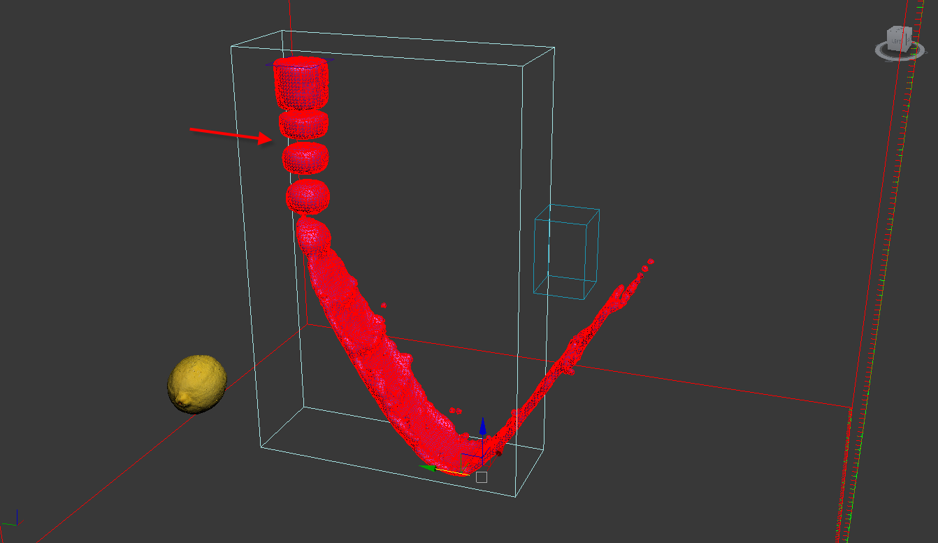

    Hi,
    How I can fix the segmented water? since now there is no SPF (or maybe just me can't find it) in the nightly (2.25.01) , how I can fix my water stream and make it more connected?

    Hey,
    The SPF is in the Dynamics panel now - everything from the Liquid panel is moved there now.
    Is the emitter object moving or static? A moving emitter could also cause such behavior.

      tks. Will try it out.
      It is a static emitter. I was trying to recreate the scene in this tutorial DVD
      https://www.amazon.es/Introduction-S.../dp/B000Q66FC0
        Sweet
        So the SPF should do the trick, but if there are any issues, give us a bump
