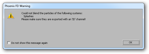

      Now I experience another problem: Motion Bluring vs. splashes

      What setting is missing?
        Hey,
        Looks like you are using the old PHXSimulator object - we are deprecating it and some options might stop working with the FLIP Liquid solver. If you don't have ID/Age etc under the Splashes rollout, then it would be better to use the new Liquid-only simulator.
        The toolbar has undergone several fixes already, but they are not in the 2.2 nightlies. If nothing happens, then most likely the emitter objects are already selected in another source - there are no warning messages about that in the nightlies neither. Not sure why you had a PHXSimulator already in the scene - it would be best if you have just the emitters and the preset will create all required sources, simulator, shaders, etc.
