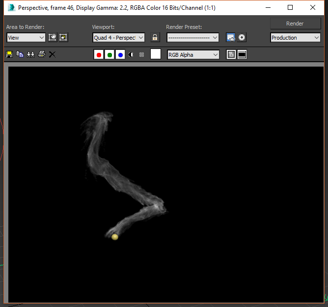

    So I just created a basic cigarette smoke simulation and tried a path follow - that works nice.
    I whack in an omni and his render - scanline works OK.
    Same thing with Vray (trying different shadow types and lights) and just massive sections of the smoke aren't rendered.
    WTF?
Name:	Screenshot 2017-04-01 17.16.40.png
ID:	887396Click image for larger version
Name:	Screenshot 2017-04-01 17.15.54.png
ID:	887397max 2015 why wont vray render this.zip

        This is because if you are using a max light, you need to set it up manually - enable Volumetric Shadows and set the shadow type to VRayShadow. This happens automatically with V-Ray lights, but for Max lights you need to do this, otherwise parts of the scene randomly will not be lit by the light.

              The thing is, I have just tested it on my laptop at home and it works - yet my work machine gives the error as described. Both are using the same version of vray and phoenix (using hamachi to serve the licence to laptop
              But consider this: is is rendering PART of the smoke - so it's not the fact it won't render the smoke at all - you can see that it is neatly cut off into sections at 90 degree angles.
              That's not a case of not rendering volume smoke - it's a bug that is happening on one machine but not another.

                Ah, yes, this is an issue with the new V-Ray adaptive lights - if you turn those off, it should work. However, this is fixed in Phoenix 3.03. Which Phoenix version are you using?
                  I guess the work machine I was using didn't have thelatest PFD - it does now and it works.
