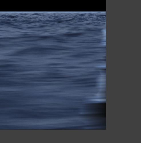

    Hi I have a issues when rendering out motion blur with my phoenix fd ocean it seems to mess with the edges of the frame does anyone know of a good work around?
    Hello,
    In the recent nightly builds we have introduced an option for this. It's in the Render options called Off-Screen Margin (%) - allows you to extend the ocean further from the borders of the camera view in order to solve such issues. The value is a percentage of the image size.
    If you don't have access to the nightly builds - send an email to support@chaosgroup.com and they will help you out.
