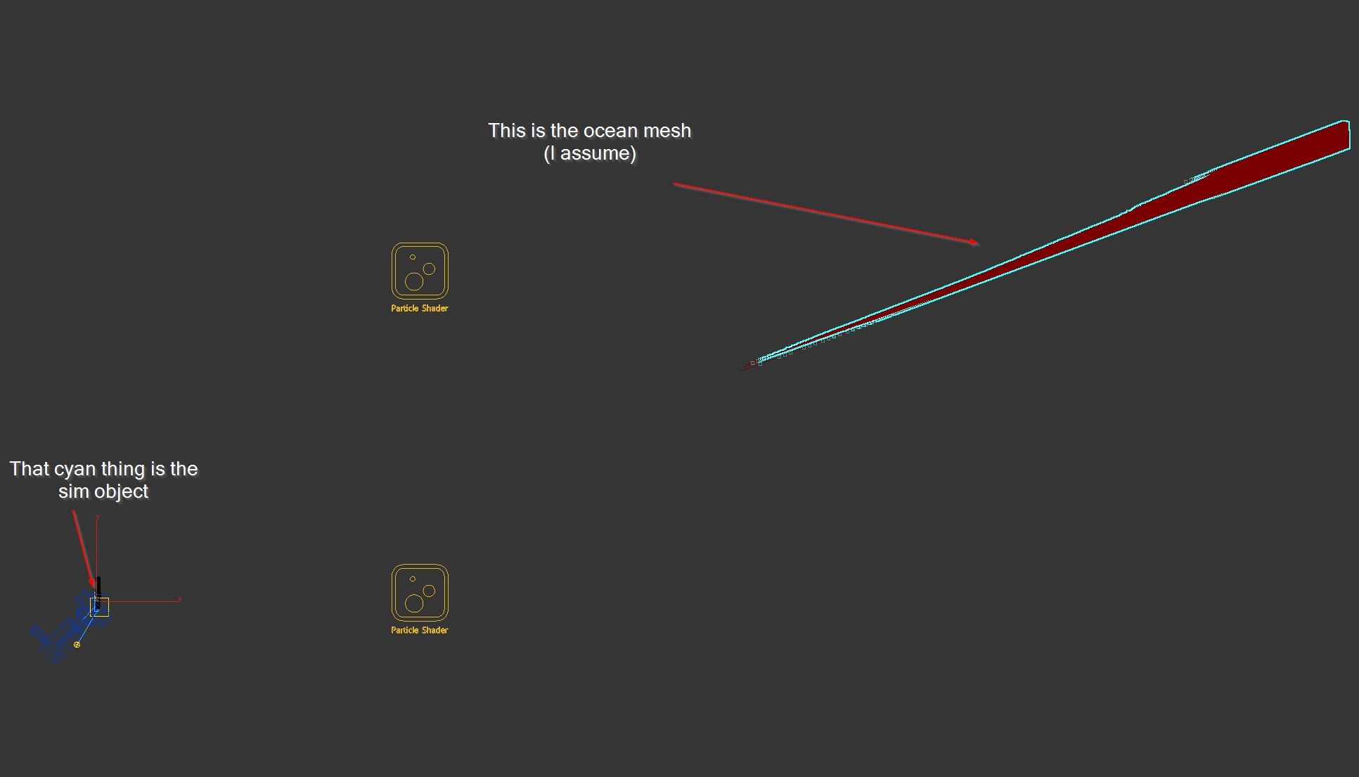

    Second, instead of learning the basics through a tutorial, I thought I'd just use the excellent presets instead. But that didn't even render! Actually, the mesh object is created hundreds of meters away from the camera frustum! Click image for larger version  Name:	2017-05-24_screengrab_000240.jpg Views:	2 Size:	127.0 KB ID:	953373
    Any clue on why this would happen?

    Hey,
    Which version are you using? Did you try a latest nightly build?
    If this still doesn't work, please send the scene over to Support. Are you using a Physical camera, or a dome cam, etc?
