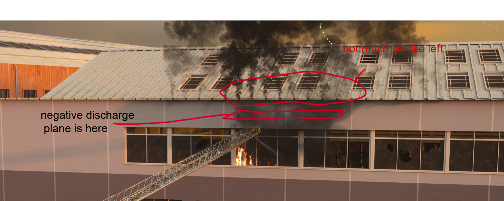

    hi we have a warehouse building on fire with open windows. Is there anyway to have flames sucked in through the window because of the window drag, Wind does not work well. thank you
    You can make a source with negative discharge - this will get the fluid sucked.
      Thanks. it seems it moves smoke but also consumes it making less smoke come out. Not sure why it happens
        Place the plane out of the camera view (somewhere on the top). Maybe that could help. Or can you use Plain Force?
