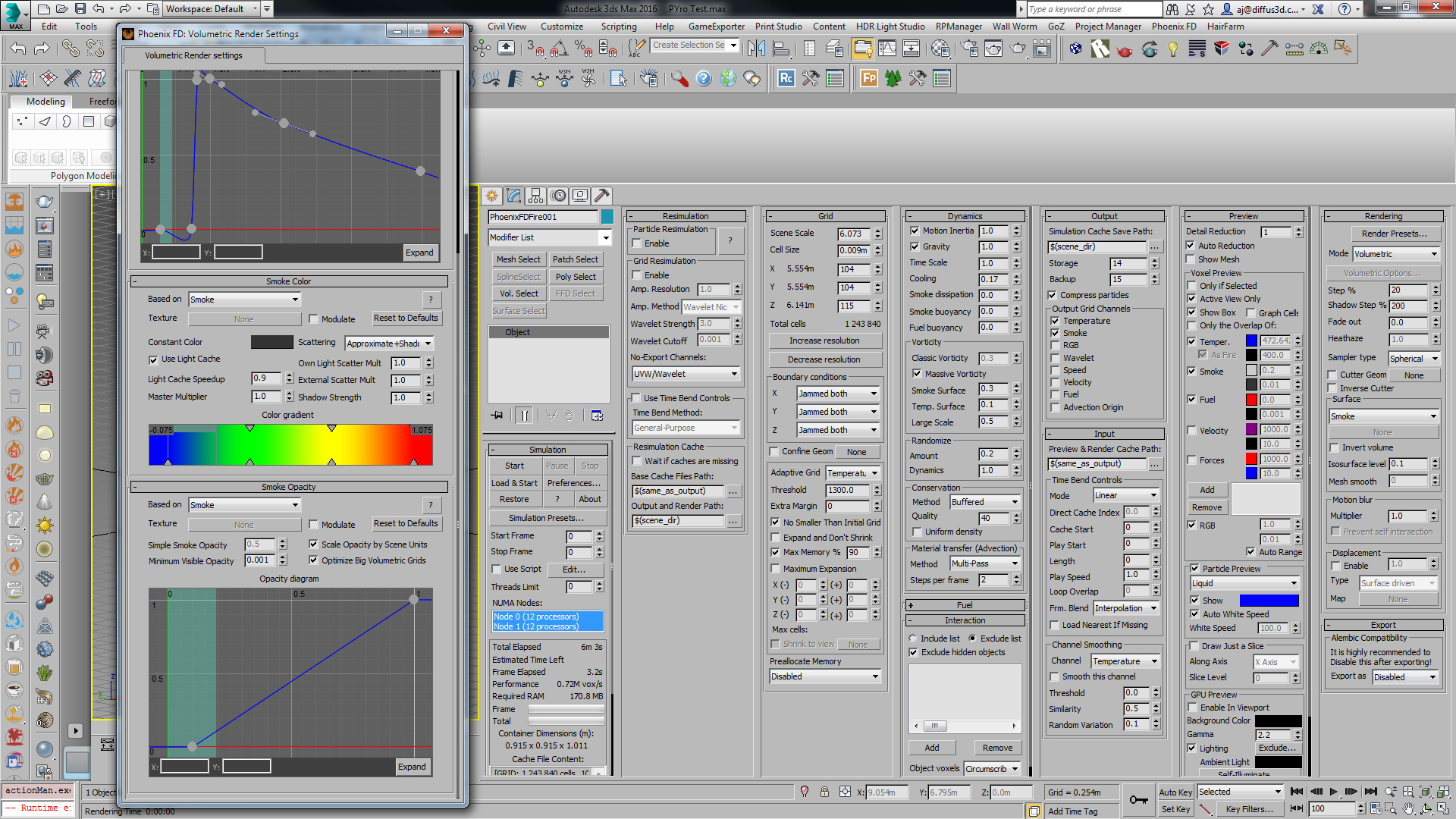

            I have some screenshots here. I can see smoke color and opacity are split now and maybe my opacity settings are wrong. I'm sure the problem likely exists between the keyboard and the chair but thanks for any tips!
            Best,
            AJ
              It looks like the problem was just my opacity settings. When I use simple smoke it's working ok. I tweaked the smoke preset opacity by moving the left key to the left a bit more and then the smoke started showing up. Thanks for all your help, I think the problem was just ignorance.
