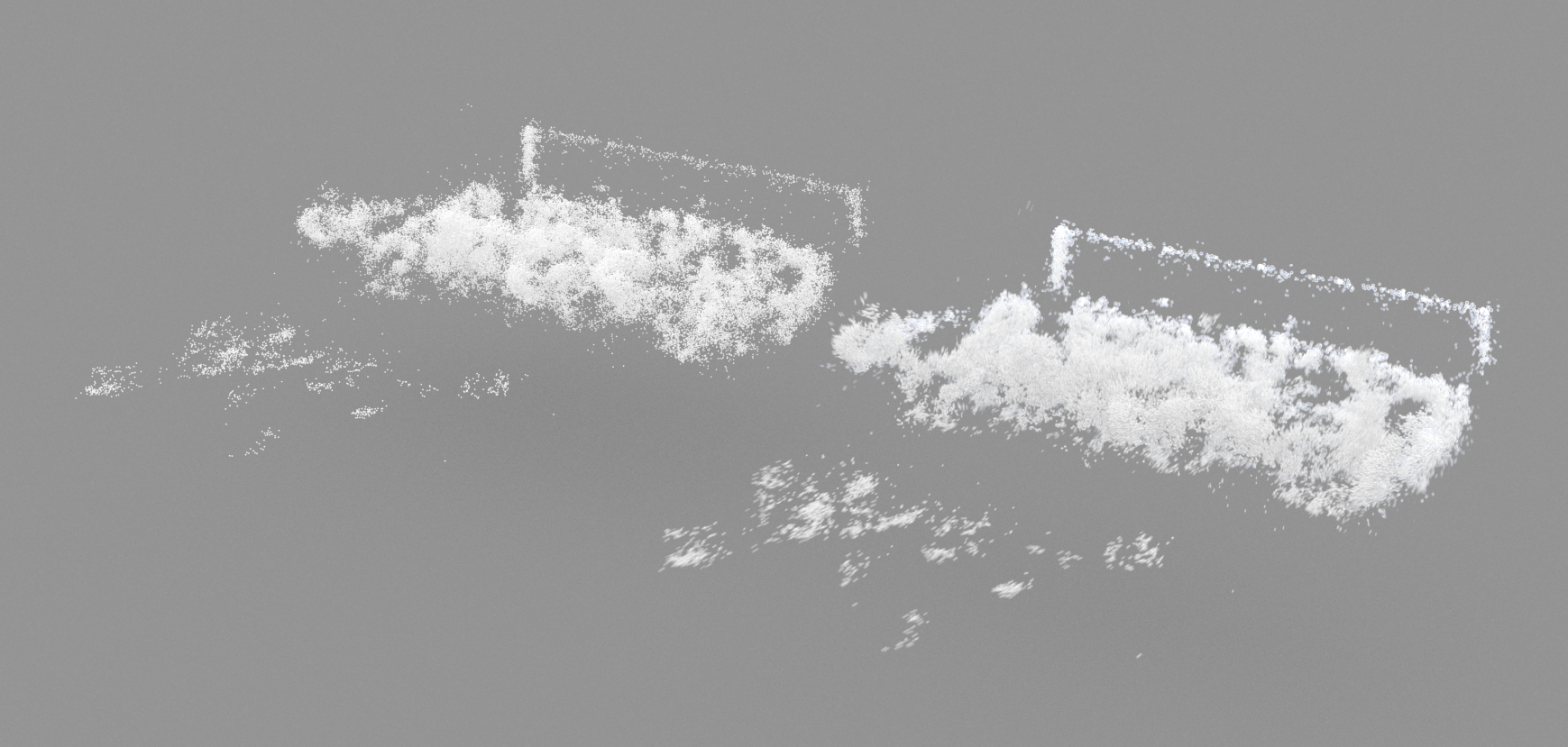

                        I did everything like in the video. The particles from the simulator got definately velocity information. When I export them as PRT Sequence, load them in Krakaoa and watch it with the Particle Data Viewer Utility i can read the velocity vectors for every particle.
                        Here I attached a rendering.
                        On the Rendering:
                        Left side: VRayProxy with Alembic Loaded
                        Right side: PHXFoam Particle Shader with the Particle Sequence directly loaded from the simulator
                        On the ViewportGrab:
                        Left side: PRT Sequece directly exported from the simulator and loaded with a Krakatoa PRT Loader, Display set to Velocities
                        Right side: VRayProxy with Alembic Loaded
                        Bottom: Krakatoa Particle Data Viewer Utility with velocity vectors present
                        • #13
                          If you right-click on the VRayProxy - to to V-Ray Properties and enable the Velocity Channel checkbox, then set the Motion Blur Multiplier to 1000. As this is the Maximum value in the UI, but we need to increase it a bit more.
                          Close the V-Ray Properties window and right-click the Proxy again and go to Object Properties and from the User Defined tab set the VRay_MoBlur_Velocity_Multiplier to 4800.
                          This should give you proper motion blur. I will make sure to add the steps to the docs as well.
                          Cheers,
                          Georgi Zhekov
                          Phoenix Product Manager
                          Chaos
                          • #14
                            Thank you! It works fine now.
