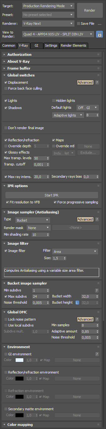

    Can anyone advise me on how to get a decent lighting in my interior?
    My settings are defenitely not too low, but still I get thes spots...
    Please have a look at the attachments and rendersettings I'm using now.
    I've setup a HDR dome light in combination with a vray sun for the lighting.
    Thanks!
    Pieter

    just transfer to BF/LC workflow and youre sorted with spots

          Start with defaults settings for that thats MSR 6 AA 1/24 and NT 0,01 and use vray denoiser set to 0,3 strength and 2px radius.
          If youre not happy go for NT 0.005 or raise the AA

                Your IR subdivs and LC retrace threshold are reason for this behavior. No need to change these in my view
                These are the settings that I would use personally for this kind of scene, Reset everything to default first and only change these,
                sampler type, bucket
                Min subdivs 1
                Max subdivs 32
                Min shading rate 16
                noise threshold .008
                Primary GI engine BF
                Secondry engine LC DEFAULT VALUES, only change subdivs to 2000
                Now, if you want cleaner result, you can go down on the noise threshold and don't change anything else.
                Adding Sample Rate and GI render elements will help you solve this kind of issues usually
                Your GI render element will show these splotches all over the place.. You are making things harder on you really ,playing with IR subdivs and LC retrace threshold. More subdivs doesn't mean better IR quality really, but it can affect details
                If you want to use IR, Reset everything to default, then using the medium preset, change Max rate to 0 isntead of -1 , And color threshold to 0.3
                Don't change anything else.
                For LC, use default values and only change the subdivs to 2000
                This should get rid of these spoltches, but personally I don't use IR in my interior renders. BF is way better in areas of contrast and shadow and it is not that slower than IR in Vray next. The difference is very tiny with the settings I mentioned above.
                Also I don't like your sampling settings :/
                Using max subdivs of 12 is not enough really. Many areas will be cutoff, ie the max number samples are not enough to achieve the noise threshold you aim at.
                With interior scenes, I wouldn't recommend anything below 24 (which is the default value)
                Using 12 will cause many areas to be cutoff in your render,so If you add a sample rate render element, you will see that almost everything is red, which is not good
                No idea why you used min shading rate of 10. you can leave it at 6 for all of your scenes and use the noise threshold to control how clean your render is.
                Personally I would use 16 for this specific scene which is GI intensive.. This will help with cleaning the noise, even without going down on the noise threshold.
                Also, use bucket sampler for this kind of scene, it is way faster than progressive and gives cleaner results with the same noise threshold. You will need to use something like 50 or 100 for Max subdivs with progressive.

                  Spots in the reflection look like some artifacts of a none vraymaterial in the scene. (But could be something else, hard to tell without a scene or passes to investigate)
                  Light cache shouldn't be this high for a still. I leave it at the default of 700. Also turn on use for glossy rays in LC.
                  Wouldn't use Ambient Occlusion either (slows down render) and looks fake but that's a personal opinion of course.
                  Set the burn value somewhat lower for instance 0.2 or similar but set the color mapping mode to none don't apply anything and fiddle with the burn value in the VFB (this way you have all the information you can get in the image and the speedboost of reinhard not sampling in overbright areas), and you can use lens effects when necessary.
                  As for the noise, with these settings you shouldn't have that much noise imo, could be material related (texture sharpness, bump, unreal material settings,..) or maybe scene related (lighting/camera not physically correct)

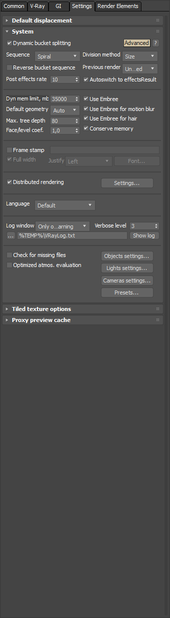

                            Hi there,
                            I'm still working on optimizing my model. However I've got decent interior render results, the time it takes is way too much (in my experience).
                            Something must be slowing down my render, because I'm used to get my render 8000*4000 panoramic in about 45min (using my render nodes).
                            At the moment I'm testrendering with your settings (@Muhammed_Hamed) at about 1h20 for a small size render 1200*800 (see attachment).
                            I'll be testing further here, if there are any suggestions, please let me know.

                              Sample rate indicates that Vray is having hard time with one light or more in your setup.
                              What did you use for your lighting?
                              Are you overexposing your render and using lower exposure in VFB?
                              How many cores you have on your render nodes?
                              At this resolution and for way more complex scenes than this, I get render times between 20 to 30 minutes on an i7 7900X @4 GHZ (10 cores, 20 threads)
                              This one took 24 minutes and pay attention to how the sample rate pass looks like
                              This scene has over 600 textures with plenty of glossy materials, SSS and Refraction
                              I used the exact same settings I pointed above and I even used .01 noise threshold with no denoiser
                              This second render took 28 minutes.. See how sample rate looks like
                              This is 3.6 ,so Vray next should be even faster..
                              With Vray sun and sky, I believe you still need to use portals
