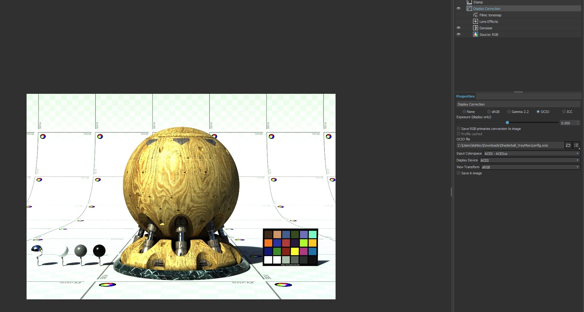

              I haven't had time to experiment with ACES yet in any way. I've loaded the aces 1.2 ocio file in the display correction and set the view transform to sRGB. Where do I control the highlights? I've set the renderer to Vray CPU though, do I have to set the color management in the render settings to ACEScg too?
                  In the Frame Buffer, input colorspace needs to be ACEScg. Like what I have in my screenshot in my post above
                  And View Transform = sRGB
                  Then you need to swap color management to ACEScg, and check "Auto RGB primaries for Bitmap textures"
                  Now you are rendering in ACEScg, the workflow in Vray is very easy.
                  Setting your View Transform to sRGB (ACES) simply takes care of your highlights, this ACES View Transform includes Tone Mapping that expands mid-tone contrast and compresses the shadows and highlights. The aim of that is to produce an image on an sRGB monitor which is a good perceptual match to the original scene. This Tone Mapping/contrast is not just a LUT, it is set carefully by color scientists of the Academy
                  For me personally I adapted to this ACES look throughout the years, I might use a curve to reduce the contrast a tiny bit.. but overall I like this ACES look a lot
                  If you still want to control the highlights and do your tone mapping manually, it is still possible. Swap display correction to sRGB and add a filmic tonemap layer

                      Great thx man. I understand now, but that means I need to convert every little thing in my scene for this workflow? So all my assets, premade materials etc... that's a LOT of work.
                      edit: even with these correct settings applied my image seems quite blown out, see attached screenshot.
                        Your ACES 1.2 folder needs to be this size,
                        Click image for larger version  Name:	Screenshot_79.jpg Views:	0 Size:	65.8 KB ID:	1121535
                        And it contains this,
                        Click image for larger version  Name:	Screenshot_80.jpg Views:	0 Size:	38.0 KB ID:	1121536
                        ACES system is quite massive with many color spaces and transforms to manipulate them.
