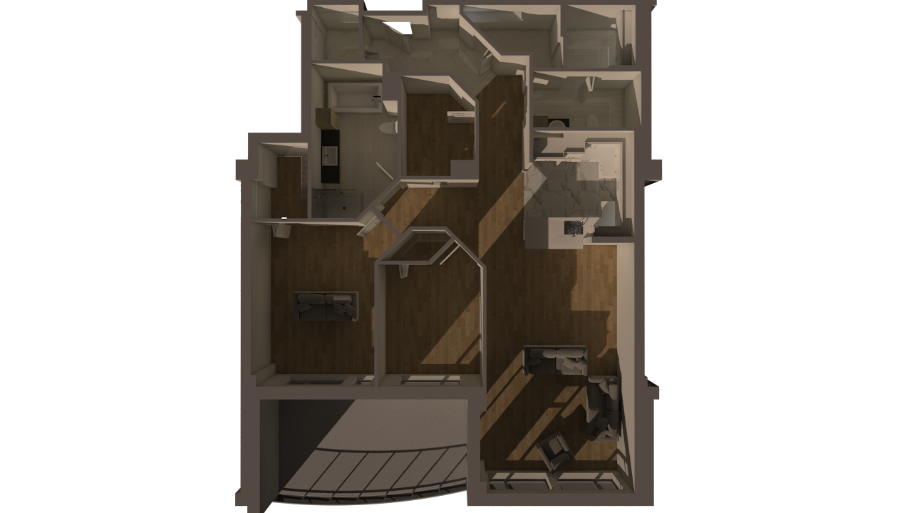

    Hello,
    If you look at my attached image...
    The sun passes over the walls and creates shadows everywhere.
    I tried to move the sun without obtaining the desired result.
    I would like to make sure that the sun comes through the windows and not through the non-existing ceiling...
    Thanks for your help !

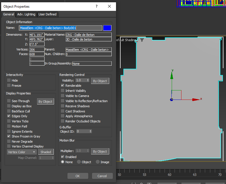

          It doesn't seem to work... maybe I have something wrong, I thought the idea was good !
          Please take a look at my attachments...
          Thanks !

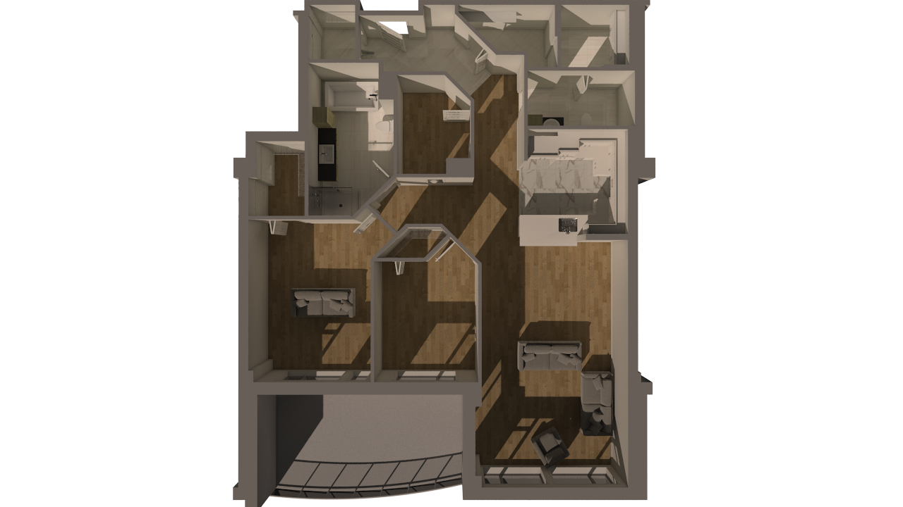

            You've unchecked everything else, so no it won't work like this. The only thinng you need to uncheck is 'visible to camera'
              Thanks again man !
