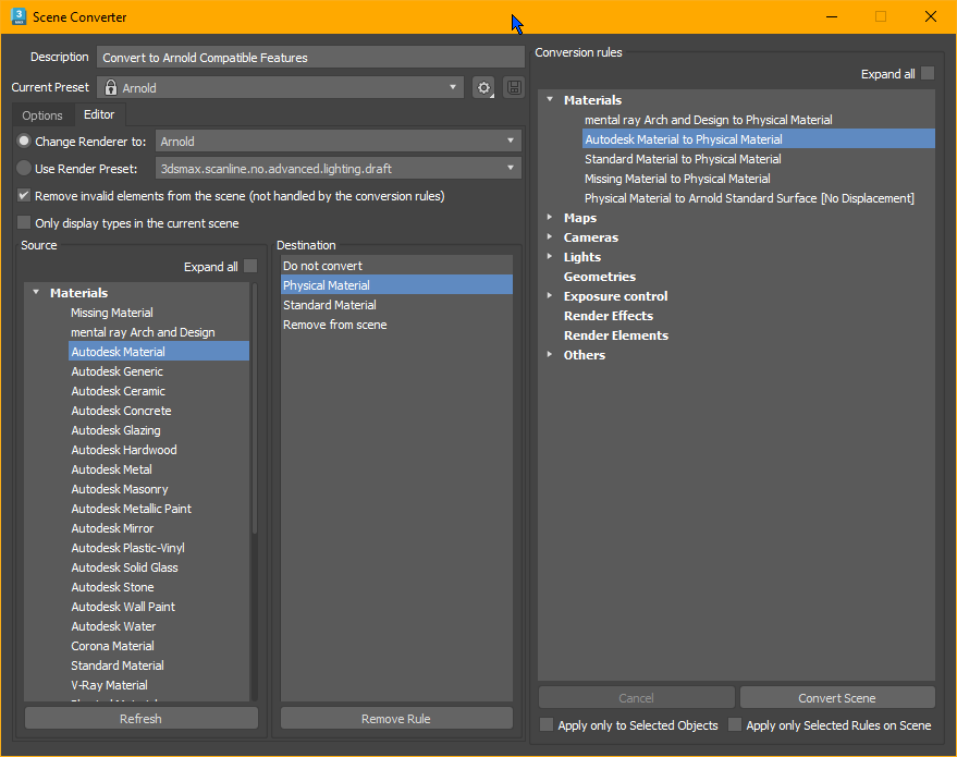

    Using the autodesk scene converter (Rendering -> Scene Converter), making them physical materials.
    Then V-Ray can convert those, or you can render them natively.
      It looks like this will work. Thank you very much!

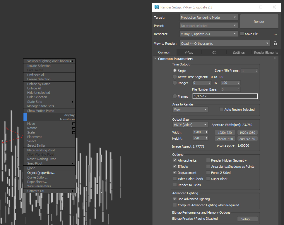

        Actually Im running into a strange issue. It appears to convert the materials to a "Standard Surface" even though I selected the same Convert options that you have. And Standard Surface wont convert. Also, for some strange reason, even though I've selected Vray as my renderer, my right click menu has lost the V-Ray options at the bottom. So I can't select the "Convert Scene" option. Screenshot attached.
        Any suggestions?
          The v-ray RMC options, in the beta for v6, are in the V-Ray menu at the top.
