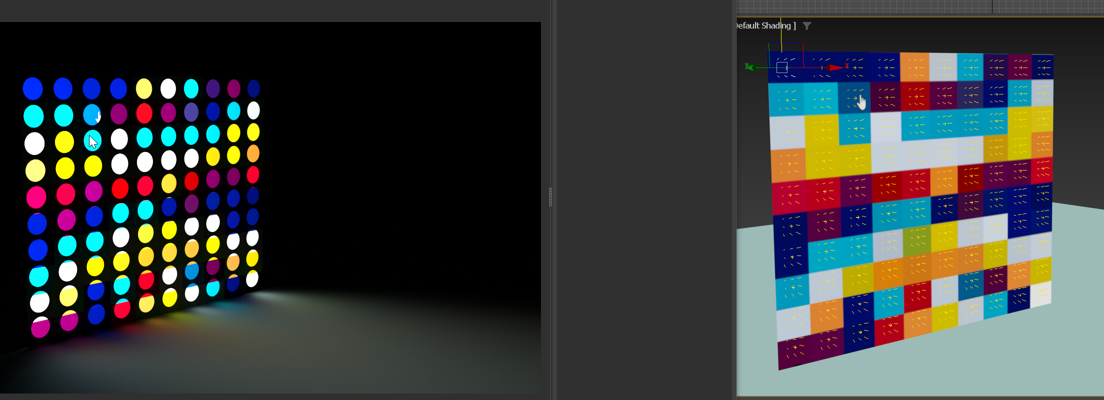

            Yes exactly, so as in the attached, where I process the image to be pixel blocks and use that for both light image and its opacity.

                  Maybe something like this, where the colour is coming from refraction.
                    This looks quite simple and effective! Thanks!

                          As you said, the refraction method does the trick in quite a simple/elegant way anyway
