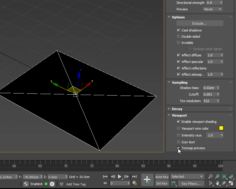

    Hello, with the recent update, softbox maps now appear in the viewport even in wireframe which is quite annoying as it hides a large part of my scenes, do you know how to deactivate this?
    thank you​
    Hi, thanks for posting. Here is the trick:

      Yes thank you
