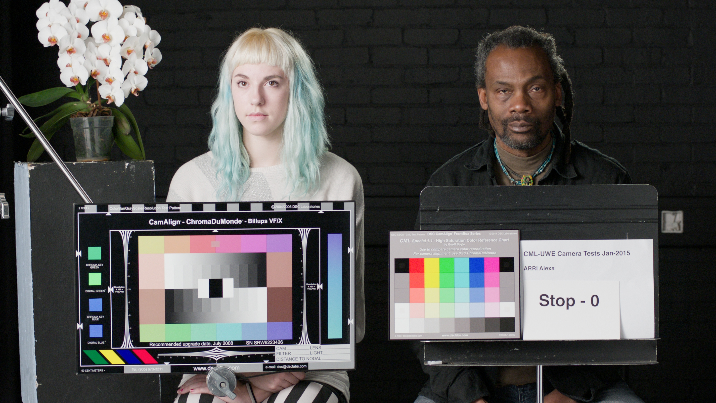

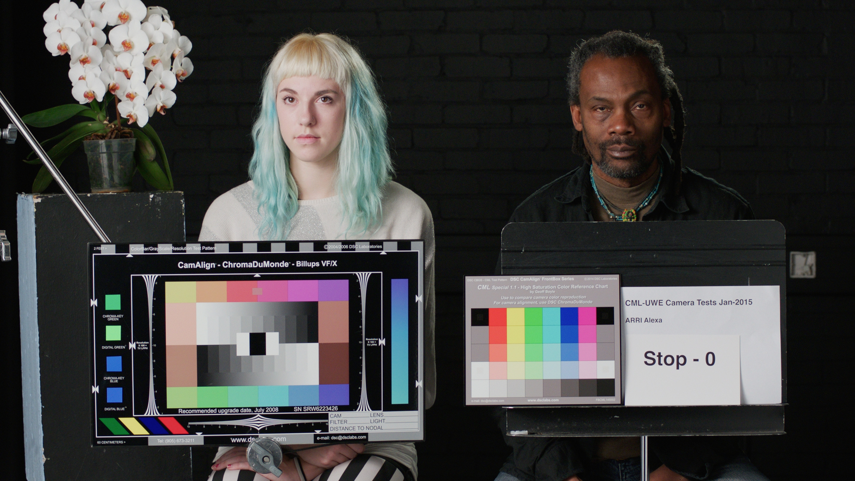

interesting read as I just yesterday thought about selling a lut pack..
the thing with a lut is that it expects a specific input: ACEScg, linear BT.709, ARRI logC etc. and outputs to specific display too.
if you don't have this data you are just throwing some random numbers around.
with luts from Corona - you need to "gamma sandwich" the lut if you want to use it as intended in any other software. one of those weird Corona design choices.
if you are looking for some nice colour recipes go to colourists and camera manufacturers not to cgi people. they figured it quite a while ago (although new ideas appear almost every year).
an example of a decent lut: (attached. it combines old famous arri K1S1 rec709 lut with AgX, resolve version, display transform)
