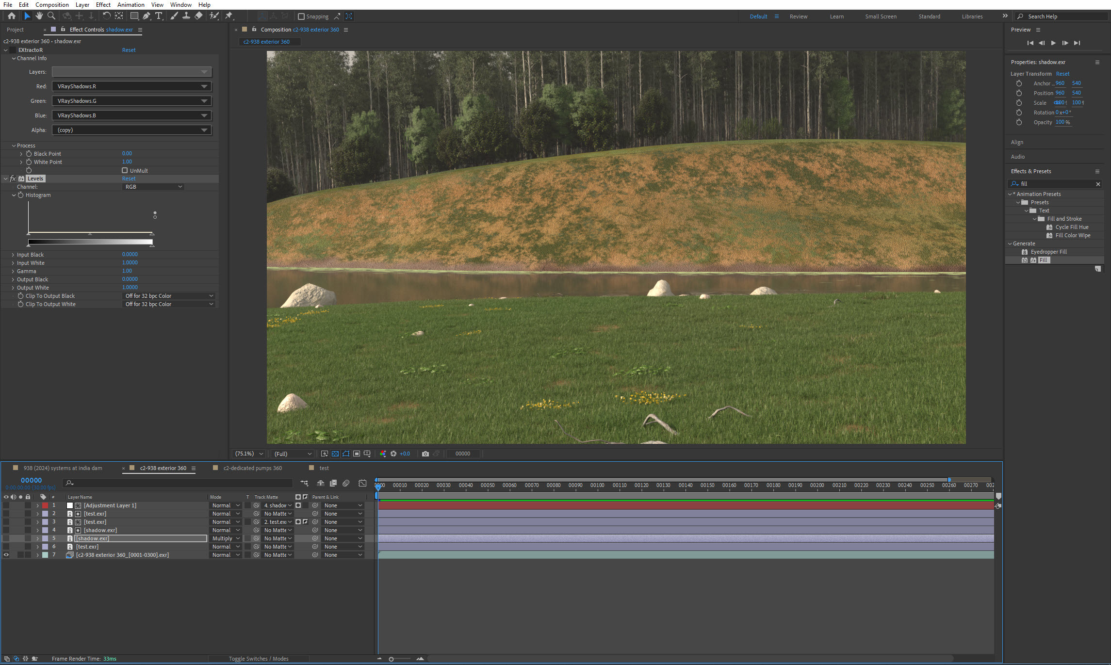

                        Thanks everyone, but let me ask a basic question, "How do I save out a shadow pass from VRay and use it in AE"?
                        I understand how to setup the scene to generate the shadow only, but it seems like there's a million ways to export the shadow from VRay and composite them in AE, but so far none of them are working for me.
                        For example, the attached is what VRayRAWShadows produces in the VFB. So far in AE I either get a too light of a dark shadow or it's white. What do I with that now?
                        Or should I really be using just VRayShadows? However with that I also get too light of a shadow. For some reason the shadow is always lighter than it would be in the beauty pass.

                          Are you familiar with Track Mattes in AE? You can use what you have as a track matte to mask an Adjustment Layer. The Adjustment layer would then have a levels or curves (or multiple effects) to darken the BG image to match the other shadows in the scene.
                          Track matte info here:
                          https://www.youtube.com/watch?v=pRP86xCworA
                          https://www.youtube.com/watch?v=rvAX...bnQgbGF5ZXI%3D
                          In the image below you would put your rendered shadow in the middle layer (blue) and the adjustment layer (red) is on top. The bottom layer would be your BG image sequence (source footage you are comping into).
                          You then set your middle layer to be the Track Matte for the top adjustment layer. First click the Toggle Switches/Modes button (bottom green). Then choose the middle layer from the Track Matte popup (underlined green). If your shadow data is in the RGB (luminance) rather than in the alpha channel of your shadow render the click the little square to toggle to Luma matte (green arrow). If you need to invert your matte click the box to the right of that.
                          Note that when you set the Track Matte it will hide (the eyeball on the left) the layer you are using as the track matte. This is what you want. Don't turn it back on.
                          Then you have something like a levels or curves effect applied to the adjustment layer which darkens your image to match the shadows to the shadows in the BG plate (Bottom layer). Because you have a Track Matte setup the adjustment layer will only affect the unmasked portions of your BG sequence (where the shadows are). So you are darkening the pixels in the BG sequence that are where the shadow matte is.
                          Hope this helps.

                          Note that I would still disable shadow casting for your grass object because it appears to be receiving shadows from itself.
                          To make the shadow pass I usually do not use any Render Elements. Instead I use a Scene State like I described above where I have only the shadow catching objects visible to camera (grass and ground plane). The shadow CASTING objects are set to be invisible to camera (usually via layers, but can be by object). This gives you the shadow in the ALPHA and a black RGB. In this case you would set your Track Matte to use the Alpha, not the Luma(nance).

                            Hi. Yes, familiar with track mattes and think I have tried what you are explaining, the difference being in that my background image has no shadows in it. I am wanting to composite the background image sequence + vehicle shadow sequence + vehicle. When I try and adjust the shadow darkness either by the method you suggest or simply adjusting the shadow layer itself, it doesn't look good when compared to the beauty pass I posted earlier in this thread. That shadow layer has the shadows in the RGB layer (although the background colors is also black, so they're not visible in the RGB layer), it has them in a VRayShadows channel, and in the alpha channel. The shadow pass channels VRay creates are inverted, so I am wondering if that is the reason for this, even though I have tried inverting them?
                            Also, I am rendering my shadows the way you suggest, but is your env background also black? Mine is, and there is no shadow in the RGB channel but only the alpha.
