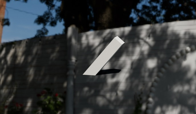

why does shadow catcher not work over objects? Is there a workaround?
I have objects of selfillumination (they are reference images an represent a projected scene) and now I need shadow over them.
I need to see this live in the IPR and not only after composing.
I tried MaterialWrapper, ShadowCatcher with Alpha -1 and even Vray LightMaterial was not working (in hope it is treated in the same way as the HDR).
Attached screenshots, it's currently not possible to have self-illumination with shadow, but this is needed in movie projection workflows.
Test with MaterialWrapper:
with a diffuse I see of course the shadow, but this is nothing else than a standard material
shadow catcher works only on HDR, as soon as I put anything between, image gets black
