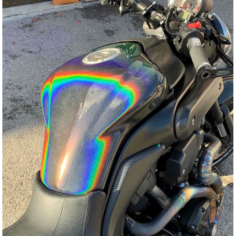

    Is there any way to reproduce this effect using 3dsmax & vray? Basically I need to create a rainbow effect in the flakes that are controlled by the camera viewing angle. I guess the setup would be similar to a pearlescent type shader.
    https://www.youtube.com/watch?app=de...ArvidSchneider
    A real life example of the effect I'm trying to achieve.
    https://www.youtube.com/watch?v=TYSv...ustomzwarriorz

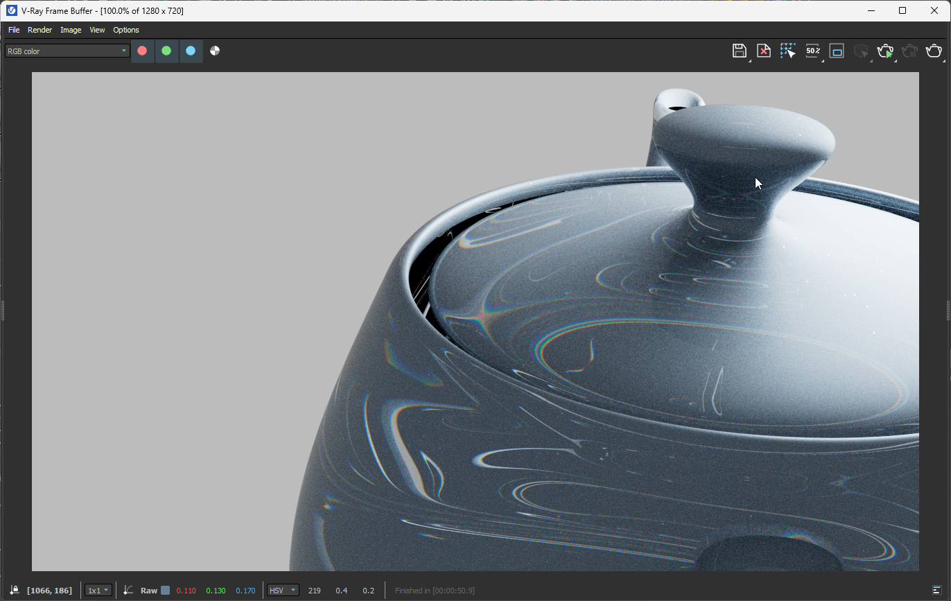

    Hi, thanks for posting. This effect is caused by the light reflecting from the flakes and passing trough thick layer of lacquer.
    I tried using a car paint material as a base layer in a blend material. The coat layer is a glass but with enabled abbe number checker. This is what I got:
ID:	1218952Click image for larger version
    I am not sure if this is the same or usefull but just an idea to consider.

      Hey. Thanks for trying this out but I'm not sure the result looks like the car paint featured in the video. Although it is producing a rainbow effect it seems that it is not over a wide surface area and only on very specific areas of the surface, creating those lines. Maybe it's an IOR thing, not sure.

            No.
            The properties of the pigments create the effect. As seen in the second video, the clear coat is not involved. The rainbow effect is also visible without clearcoat.
            Also, the rainbow effect is defined by the light sources, not by the camera position. In overcast lighting scenarios, the effect will not be visible. It works best in direct sunlight or at night with artificial light sources.

                    I think it's all focused around the specular/light location based on this image:
                    If it was camera based I'd expect the rainbow to be centered a bit to the left as that looks to be pointed towards the camera a little more than the area where the specular highlight is.

                        It is focused on the specular location, most definitely.
