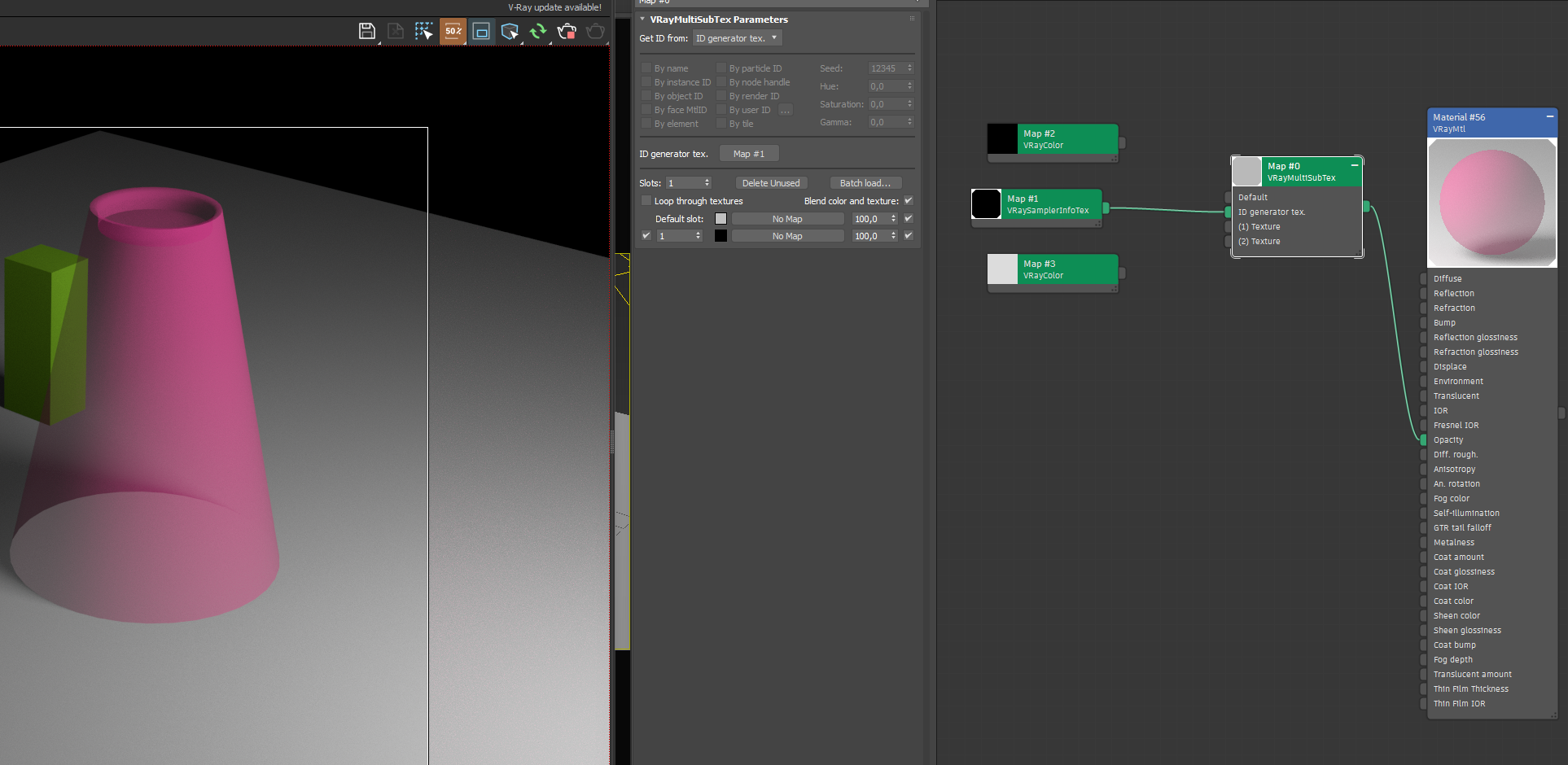

    Click image for larger version  Name:	bug Vray SamplerInfText.png Views:	0 Size:	534.9 KB ID:	1221625 Click image for larger version  Name:	03_IDGenTex_Slots1_DefSlot-V0_ID0-V128.png Views:	0 Size:	1.06 MB ID:	1221626
    Is it a bug ? Am i missing something ?

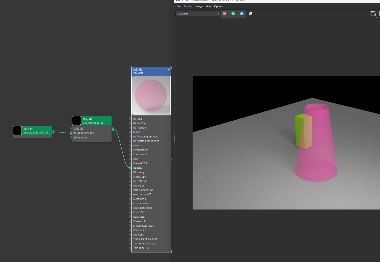

        Something like this doesn't work for you? (Sorry the forum replace the slot notations with "Home" and "Forum", now fixed).

          Can you upload your scene ti test on my side ? Because i get a different render even with your setup

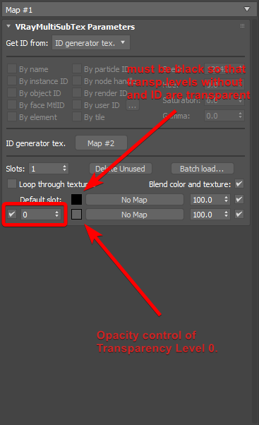

                      When using the VRayMultiSubTex's ID generator tex., the additional slots control the color, based on transparency hits.
                      In the attached image, the big plane is shaded with a VRayMtl and VRayMultiSubTex plugged in its Diffuse. Above it, six fully transparent little planes are stacked on top of each other. When a transparency ray goes through one plane: the rendered color is from VRayMultiSubTex slot 1. When it goes through two planes - slot 2 and so on.
                      The disappearing effect works by controlling the opacity, based on the 0th transparency hit (direct). ̶F̶o̶r̶ ̶t̶h̶i̶s̶ ̶r̶e̶a̶s̶o̶n̶,̶ ̶c̶o̶m̶p̶l̶e̶x̶ ̶o̶b̶j̶e̶c̶t̶s̶ ̶(̶w̶h̶i̶c̶h̶ ̶r̶e̶q̶u̶i̶r̶e̶ ̶m̶o̶r̶e̶ ̶t̶r̶a̶n̶s̶p̶a̶r̶e̶n̶c̶y̶ ̶h̶i̶t̶s̶)̶ ̶n̶e̶e̶d̶ ̶t̶o̶ ̶h̶a̶v̶e̶ ̶a̶d̶d̶i̶t̶i̶o̶n̶a̶l̶ ̶"̶b̶l̶a̶c̶k̶"̶ ̶s̶l̶o̶t̶s̶ ̶s̶o̶ ̶a̶s̶ ̶t̶o̶ ̶s̶a̶y̶ ̶t̶o̶ ̶V̶-̶R̶a̶y̶ ̶t̶h̶a̶t̶ ̶t̶h̶o̶s̶e̶ ̶t̶r̶a̶n̶s̶p̶a̶r̶e̶n̶c̶y̶ ̶h̶i̶t̶s̶ ̶s̶h̶o̶u̶l̶d̶ ̶b̶e̶ ̶i̶n̶d̶e̶e̶d̶ ̶t̶r̶a̶n̶s̶p̶a̶r̶e̶n̶t̶.̶ ̶O̶t̶h̶e̶r̶w̶i̶s̶e̶,̶ ̶a̶n̶y̶ ̶h̶i̶t̶s̶ ̶a̶b̶o̶v̶e̶ ̶t̶h̶e̶ ̶s̶t̶a̶t̶e̶d̶ ̶o̶n̶e̶s̶ ̶i̶n̶h̶e̶r̶i̶t̶ ̶t̶h̶e̶ ̶d̶e̶f̶a̶u̶l̶t̶ ̶c̶o̶l̶o̶r̶.̶

                      The thing to note is that VRaySamplerInfoTex's Transparency Levels get the data so to say globally, for the rendering. Since the light (if invisible) is transparent, it counts as a transparency hit, hence the object is shaded according to the VRayMultiSubTex slot of the transp. level.
                      Overall, this may be confusing and I agree. I'll discuss the case with the product owner, maybe we can make this functionality more intuitive.
                      EDIT: There is an easy way to do this already written in the Docs, without the need for more than one slot. Simply set the default color to black so that all levels without an ID are transparent and manually set the number of the first slot to 0 (direct). Afterward, you control the transparency through the first slot's color.​ Screencap added.
