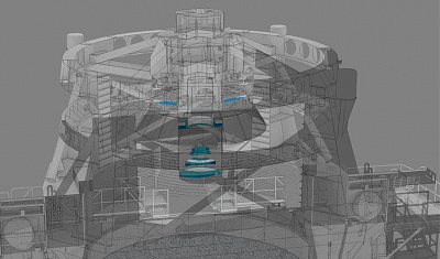

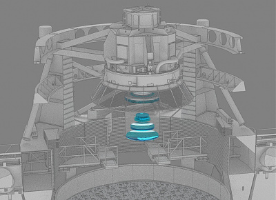

    This is the ideal situation after I replaced vray clipper with tyslicer.
    Click image for larger version  Name:	3dsmax_BptcEKuBTU.jpg Views:	0 Size:	195.2 KB ID:	1231807
    ​This image below is using vray clipper, the cuts all became a mess:
    Click image for larger version  Name:	3dsmax_7pTORcBp8c.jpg Views:	0 Size:	231.2 KB ID:	1231808

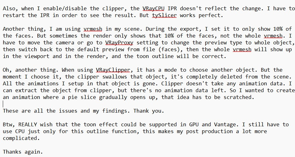

    Also, when I enable/disable the clipper, the VRayCPU IPR doesn't reflect the change. I have to restart the IPR in order to see the result. But tySlicer works perfect.
    I don't know why I can't insert more text in this post, so I have to upload as an image.
    Also a known issue (internal tracker id: VMAX-6120).
    Regarding the two other issues:
    1. .vrmesh export faces preview %: I can't reproduce this. Mind if you attach a simple scene where it is present?
    2. This also works fine on a simple scene. Maybe it affects IPR only and needs a restart? Some features, as already observed, need an IPR restart to take effect. Otherwise, extracting the mesh indeed makes the object lose its keys. I'll write an improvement request for this.
    Support for GPU is already logged as (internal tracker id: VGPU-1920).
