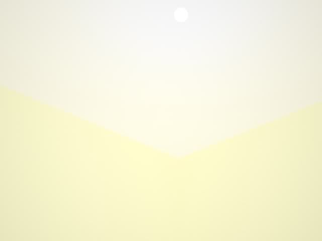

From this, I would assume that the user would not have to perform any conversions because VRay automatically makes the necessary conversions during the rendering process. I decided to create a small room that measures 120" x 120" (10'x10') to perform a lighting experiment. For my scene, 1 unit = 1 inch. I set the luminous intensity to 1500 lm (a standard 100W light bulb) and here is the result:
As you can see, everything is washed out by the light. The physical camera is set to ISO = 250, fstop = 2.8, shutter speed = 1/30s. I decided to scale the intensity light down by 0.0254^2 (converts in^2 to m^2) to 0.96774 lm. Here is the result:
As you can see, everything seems to be in much better range as compared to setting the luminous intensity to 1500 lm. However, this contradicts the User Manual, which states that the scene scale is taken into consideration. Can anyone provide any insight as to what's going on?
