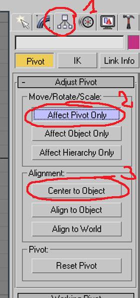

                Or just when u create proxy and pivot is moved to the 0.0.0 point , just select the proxy and do this as follow
                works for me.
                P.S. works for multiply proxy's selected
