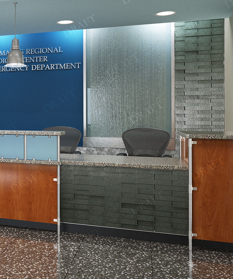

    Hello,
    I need to create a stone material like this one...
    http://www.islandstone.com/largeimag...2$hero$1$.html
    I have everything looking okay, except the reflection value. I am hoping someone could explain a good way to do this. i tried to look around for a similar mat to study, but noting I've tried works yet...
    Here is a clip from the WIP this is for...
    Thanks in advance!
    JR

      Thanks for the tip, I'm trying it now, will post results if it's not awful, lol.
        so far
        well, so far nothing promising, except that I think a big part of the problem is the viewing angle. I'll trying some other approaches, too...
          Viewing angle and lighting angle - it will only reflect like your sample if it's lit like the sample. You may need to put in a card/Vraylight to hit the right angle for it.

            Good enough?
            Well, here is an update that was good enough for today's submission to client, so thanks simmsimaging for the tips!
            I never used the vrayblend mat before, so I need to practice more, I think.
            I ended up using a vray material with a bitmap for reflection. I also used to vray lights (planes) to only affect reflections and specular on the stones only. I'm still not %100 happy with it, but it's closer...
              Glad to have helped. It's certainly getting the glossy idea across well.
