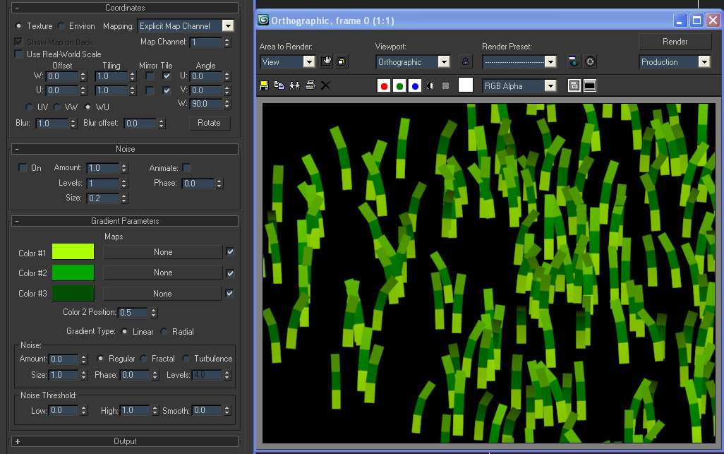

          Please elaborate. I cannot seem to get a colour change from root to tip.
          <I rotated the Gradient 90 degrees in the W axis and that seems to have worked. At 150mm, the transition from dark green at the bottom to light green at the tip is smooth. However, at 75mm long, the transition from dark green through mid green to light green is abrupt. Any ideas why this might be?>
          Kind Regards,
          Richard Birket
          http://www.blinkimage.com
ID:	843526Click image for larger version
            These images show the problem.
