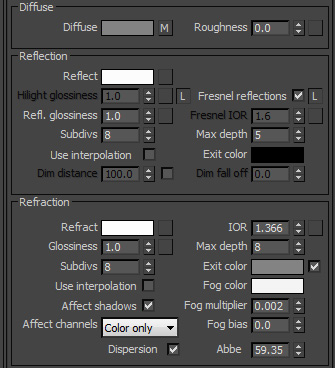

    There was such question: at enabled parameters Sub-pixel mapping and Clamp output, the transparent material has some greenish shade.
    For an example Ethanol material:

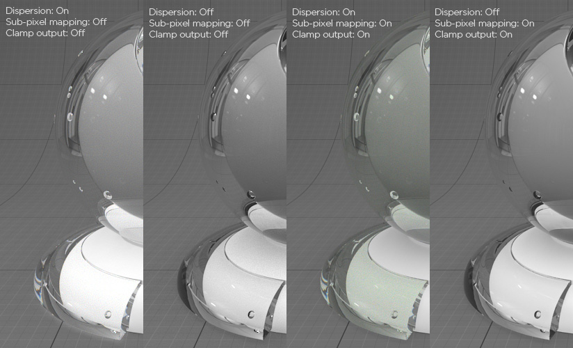

    And render:
    So should be?
      Well, V-Ray prints out a warning that the result with sub-pixel mapping may be incorrect... this is one of the cases where you can see it
