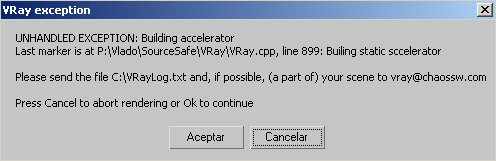

    This is an error message that appears when I try to render my scene.
    I'm shocked!
    if the image is not showed above...
    try this: http://www.fabriciomicheli.freeserve...error_vray.gif
    Now it works!
      i think that is something you should sent to Vlado at chaos.......

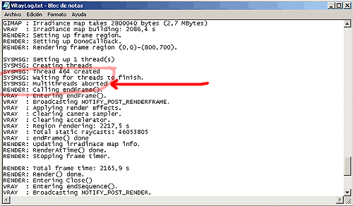

          Here's part of the VRAY log file.
          In a line, MULTITHREADS are aborted by the renderer.
          I don't know about that, but maybe it's something there...

                That could be any number of Errors. The first thing I would ask you is if you are using Dreamscape or are running low on RAM, the only two times I ever see that error are in those instances.

                  fabrizzzio: most likely it's a memory issue, maybe you have too much geometry in the scene.

                    Vlado Im also getting this error and I notified u about it, u even said that i should send a sample of my scene a while back which i did, but never got a reply...it always happens (at least with me) when i have Dscape and Vray in a scene, with Vray as the renderer for the Meditor and i want to edit my materials in the Meditor.
                    A workaround (which i honestly dont think its a workaround but at least u get rid of the errors) is to use sacnline in the Meditor but Vray in the render...but when i do this i cant see my Vraymtls in the Meditor.
