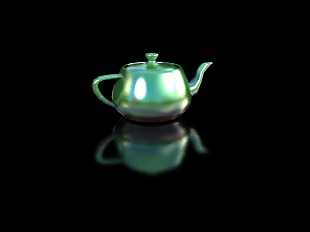

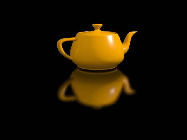

    I'm trying to render an object with its shadow and reflection on a matte object. In the vraymtlwrapper there is a reflection amount parameter but no matter what I do, this doesn't seem to work. At least it doesn't show up in the alpha. Is there really no way to do this? It seems like a real deal breaker for us using vray at this point.
    This is what I want:
