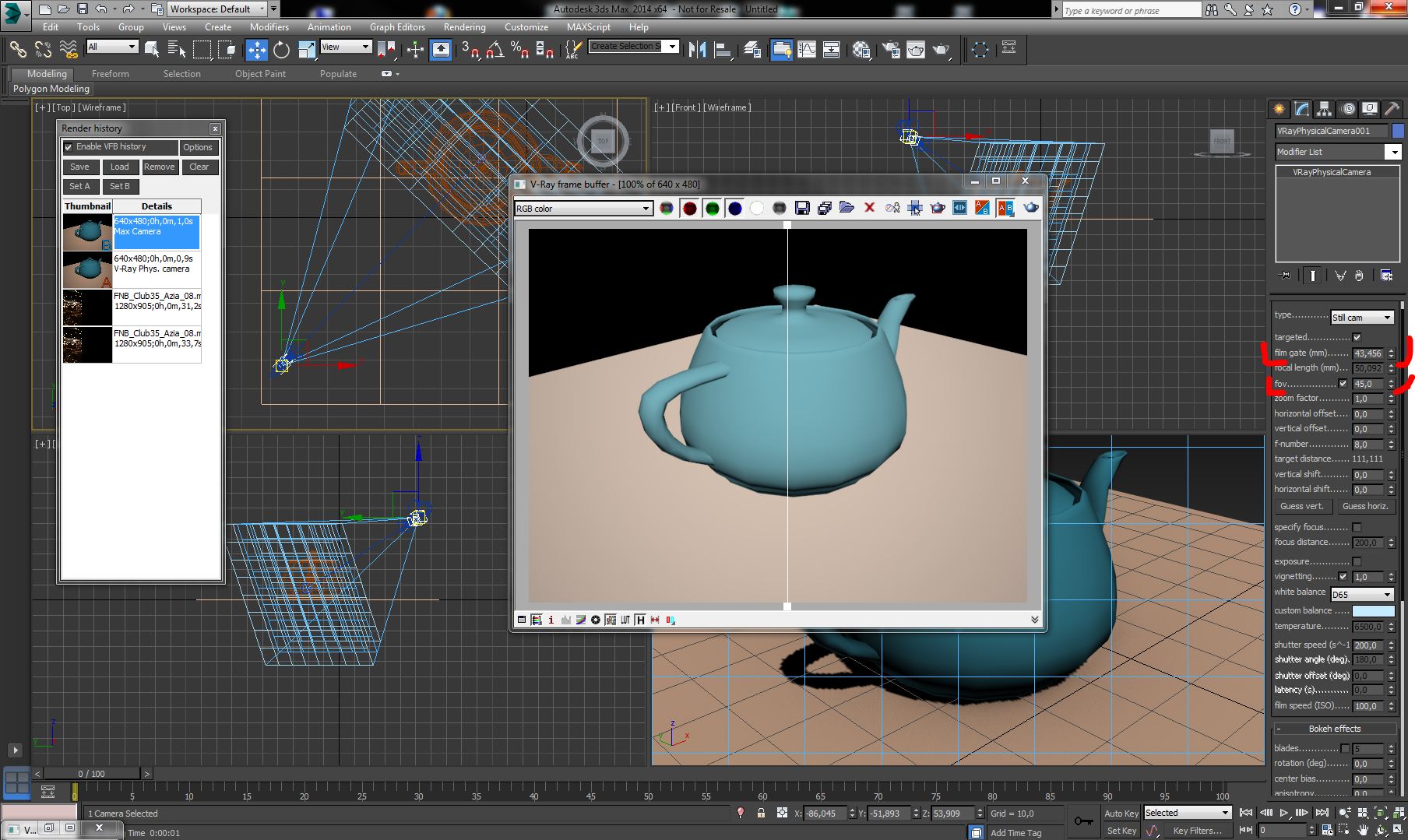

        Align tool should work in this case as well. I made a test and the render view is identical from both cameras.
        Just make sure that Lens and FOV settings are the same.

              3DSmax Align tool doesn't provide an option to align camera roll angle.
              Camera's rotation is locked to it's target and that's why it is not possible to copy manually x,y,z rotations or to catch them via align tool.
              The only option except the one proposed by cubiclegangster is to align Vray Camera to Standard camera and them copy Roll-parameter from standard camera and paste it in Vray cam - or to disable cam-targets for both cameras, then align tool should do the work without any extra efforts.
