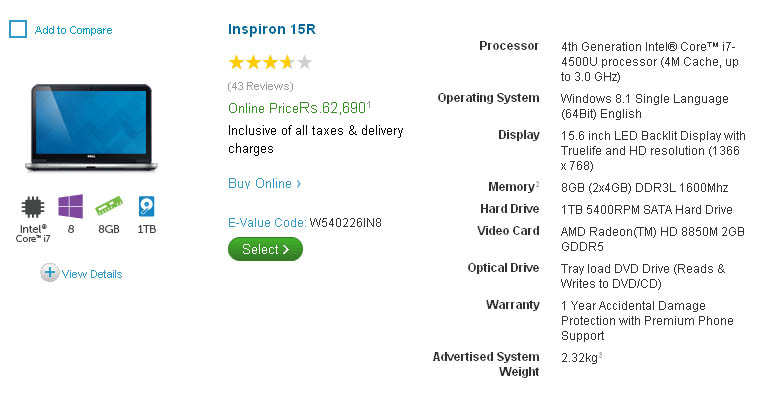

    Hi friends,
    I am going to buy a laptop..please see attachments.
    Is it fit for our Vray and 3dsmax?
    How much quality I can achive on this laptop?
    Thank you
    The thing with laptops I find is making sure they are usable. I have a laptop and went for a 19" full HD screen, as something with the resolution you've gone for is too small for me.
    Also I'd say 8gb RAM is OK, but I'd want 16gb personally.
    As for quality, that's down to you I'm afraid
    Dean
      Very bad Laptop for 3ds max.
      (*) i7-4500U ( I suggest you I7 4800MQ)
      (*) Only 8 GB? Make sure you can upgrade the laptop to 32 GB RAM (Suggestion: not less 16 GB, better 24 or 32)
      (*) 15.6" in HD??? for 3ds max? (better 17 in full HD)
      (*) 5200 RPM HDD? O my god.. this is a snail as HDD ( I suggest you 128GB SSD for OS + second 500 GB HHD 7200 RPM)
      (*) AMD for 3ds max? Ahaha Are you sure?
      This is the worse laptop for 3ds max that you can buy...

        Thanx Dean....
          Thanx cecofuli ....
